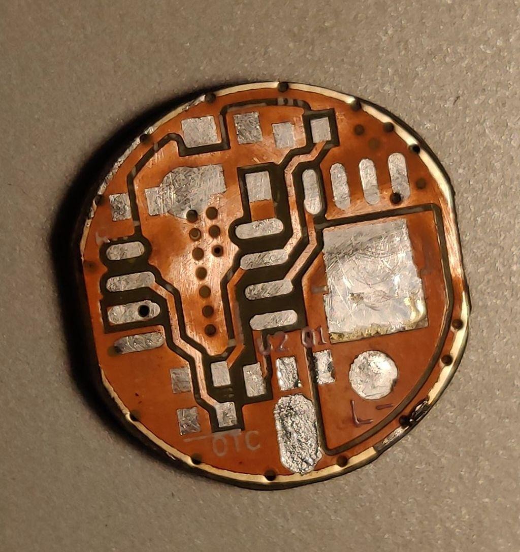

Thanks, I installed KiCad and had a go squeezing it all in to 10mm and it seems to fit surprisingly well! I was expecting to have to stack the 7135 on top of the FET, and then put the +battery contact on top of that but it wasn’t necessary. I ended up putting the power section side towards the LED, and the MCU etc towards the battery. There’s one version with the attiny13a and one with the attiny1616.
I’ve never designed a PCB before so I’m sure it could be done a lot better but it was fun to have a go.
I fear that’s the easy part though, and the porting will involve more research. I’ll have a look at the datasheets and see if I can make any headway, though I’ve never ported anything either so we’ll see how it goes!

What’s the schematic ? Is R1 R2 a batt level voltage divider ? Because voltage can be sensed from the VCC pin.
Thank you, it’s very satisfying seeing it pop up as a 3d model! Yes I do need a ground ring, I thought that would be enough but will make it larger. I will also replace the 0603 components with 0402 as you suggest (and the FET), it’s getting pretty tight on there.
The schematic is just the BLF A6/A17DD driver adapted to use the same pins on a attiny1616 instead. I stripped the PCB of one and worked out what was connected to what, put that into KiCad, then replaced the 13a with a 1616. Yes it’s a voltage divider, I gather it brings VCC down to around 1.2V for measuring.
The first schematic is based on what I saw on the driver, the second is my assumption of how a 1616 would fit. Also included is the A17DD PCB.
I found a footprint for an actual 7135 to make the 2nd one, ignore the difference there.
