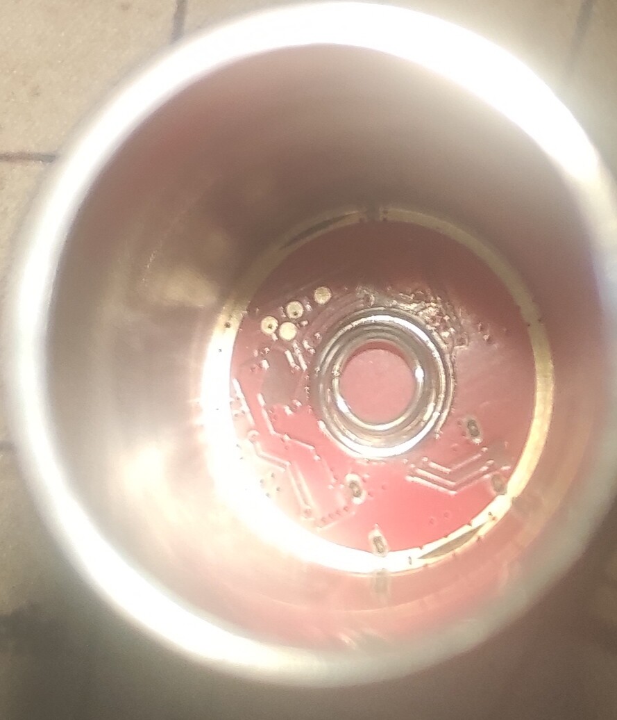

maybe I’m out to ask here, but has anyone ever tried putting anduril on lumintop B01?
That would require a new driver with a supported microcontroller.
I don’t even know how the driver is made, as usual I buy flashlights that are impossible to open like ts10 brass, copper and even titanium
In general, most lights use less capable MCUs than AVR ones. Lights that do use AVR, if they don’t use anduril, generally use narsil or similar.
zero
There are 4 pins
Pins… No Attiny MCU - no custom UI.
