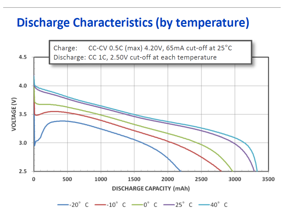

Modern 18650 batteries can work fine up to 50-60C, at that temperature it is already too hot to hold, I wouldn’t worry about the cell’s health.
This is true most quality batteries are rated for 60°C discharge temperature
as a matter of fact you can see in the datasheets that the batteries have less voltage drop and better capacity at 40°C than on 25°C
so they provide more energy when the battery gets some temperature from the LEDs
to get the battery to 40°C it probaby needs to be 15°C hotter on the positive side than on the tailcap

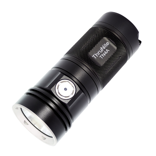

As far as a light of comparable output that does not get “hot”, TN4A from Thrunite would fit the bill $50, plus you would certainly do better with rechargable nimh batteries if you plan to use it on the higher modes. It does get warm for sure, but never to hot to hold. In reality you likely don’t need to use it on high or turbo very long, but I don’t know how you need to use yours. High quality light from a company with great customer service.
http://www.thrunite.com/thrunite-tn4a-xp-l-max-1150-lumen-flashlight/
