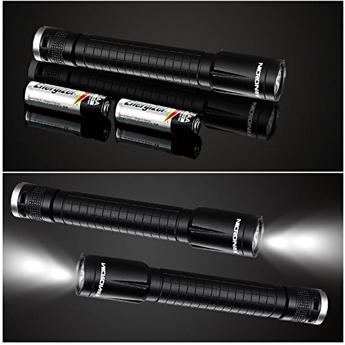

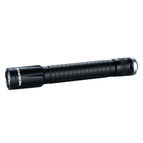

Hi,
Anyone have this 2xAA flashlight:
http://www.amazon.com/gp/product/B00J548220/ref=ox_ya_os_product_refresh_T1
or:
http://www.ebay.com/itm/201065532179
Also, has anyone disassembled it, and does it have a real pill?
Thanks,
Jim
EDIT: Pic of the light

I finally was able to get around to taking the N4’s head apart, and am disappointed:
1) The only way to take the lens and reflector out is to basically hammer the reflector from the back end so that they pop out of the front of the head. The lens itself is just press-fitted (squeezed) into the head from the front. In other words, there is no ledge on the end of the bezel/head that holds the lens (and reflector in).
2) The head ID is too small for even a 20mm board, much less a 24mm star and board.
Thankfully, I didn’t destroy the lens or reflector and was able to put the light together.
