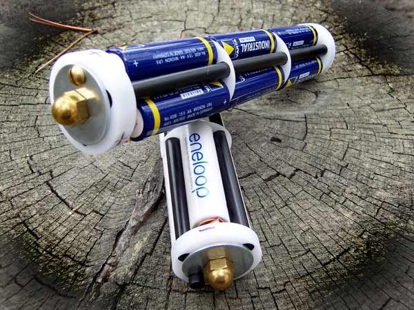

Or, rather than using adaptors like everyone else, you could just go here . In the end, this option is cheaper, has higher capacity, and has MUCH lower resistance. Seriously, these things will run a ROP light in a 6D Mag without even getting the least bit warm! (That’s around 4-5 amps!)
By the way, don’t worry about the ‘regular price’ here. They seem to like to post this higher price to make it look like the item is on sale so you will buy it ASAP.
I should also note that I have found that some AA to C/D adaptors don’t fit in some lights.
