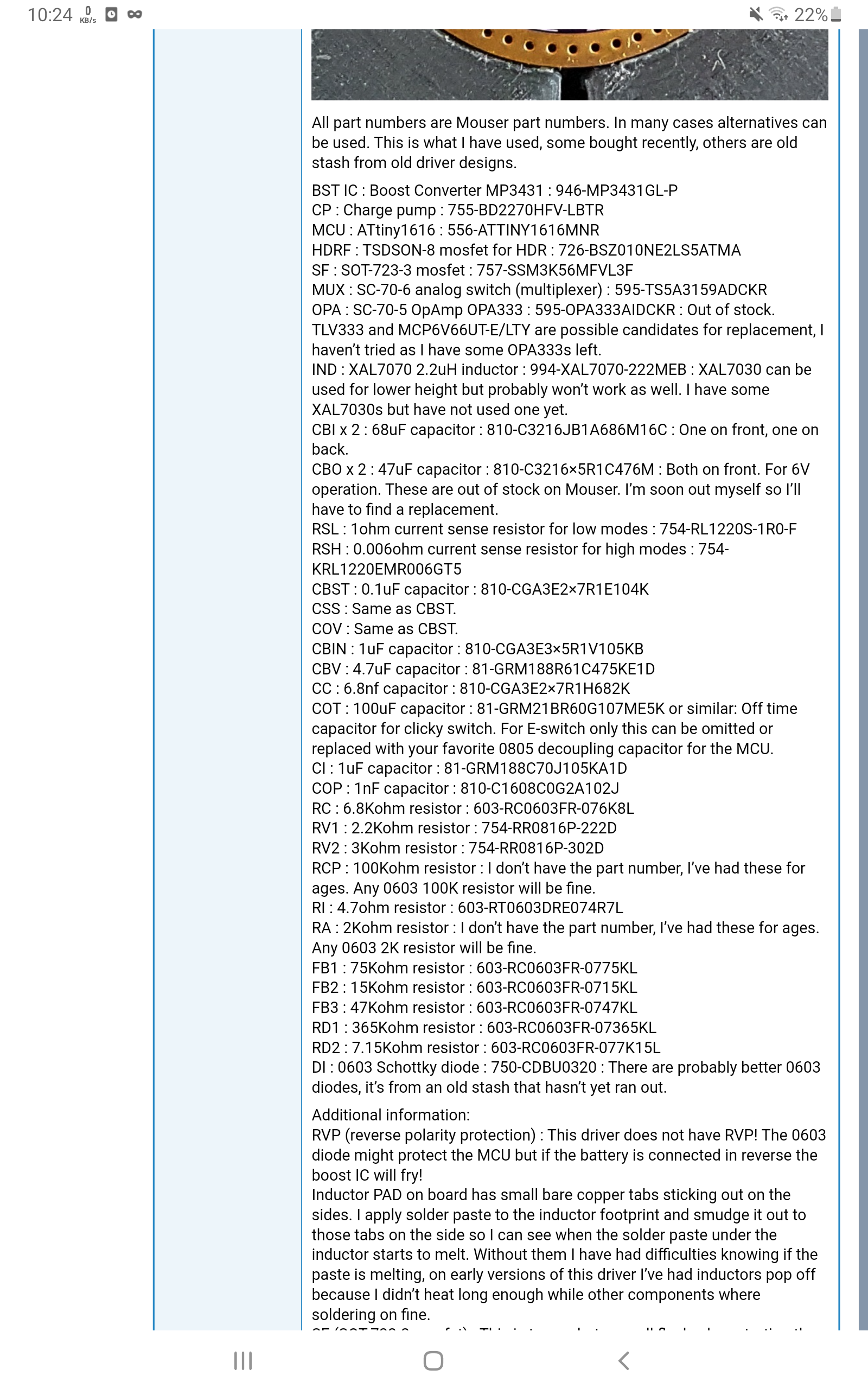

"×" and "x" are totally different.
It would probably be best to replace every "×" with a "x"
Pretty sure it’s the forum replacing it, testing...
Yep, it is
But It works with the advanced post editor.
Test : 810-CGA3E3X5R1V105KB
That is extremly annoying. And if I switch to advanced editor I loose all of my new lines, everything is if I have written it all without pressing the enter button ever.
I figured it out… If there are numbers surrounding the X, the forum assumes I’m presenting a mathematical expression and auto replaces the X. Here I am writing the exact same X in both lines:
HEYXLL
223X112
So with simple text editor I can’t change them, they are part numbers and the forum is dead set on changing them… And by going to advanced editor I loose all new lines. Perhaps I can copy to notepad, change to advanced editor, then paste everything back… Edit: That did the trick.
