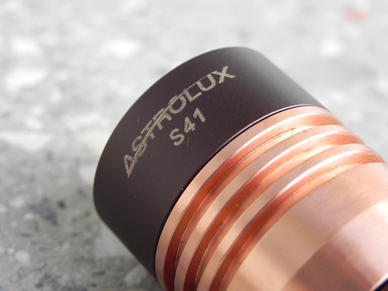

Just finished baking my Astrlux S41. I forgot all about the 350 tube it came with, and baked it with the optional 650 tube. It looks like the optional 650 tubes were possibly leftovers from the BLF A6, since the tail cap and bezel changed to a slightly different color. I will bake the 350 tube tomorrow and see if it matches. Either way, it doesn’t look too bad. If anything, the 650 tube matches the copper better than the bezel. I never liked the black contrasting with the copper anyway.
@RobertB What temperature and how long did you bake the S41? I should receive the one I ordered and 18650 tube in about three weeks. I ordered it earlier today with the intention of baking it. I hope for a closer match from newer stock but would be satisfied with results like yours. It looks good. The S2+ looks REALLY nice.
550F on bake setting. (Thats as far as mine would go). String a bare wire from one end of rack to other, string the parts through and let them hang without touching rack. Put rack in oven and bake for 30 to 40 minutes. Let cool, put o-rings back on.
I washed the parts with dish soap, water and dried them off first.
@RobertB :+1: Thanks!
