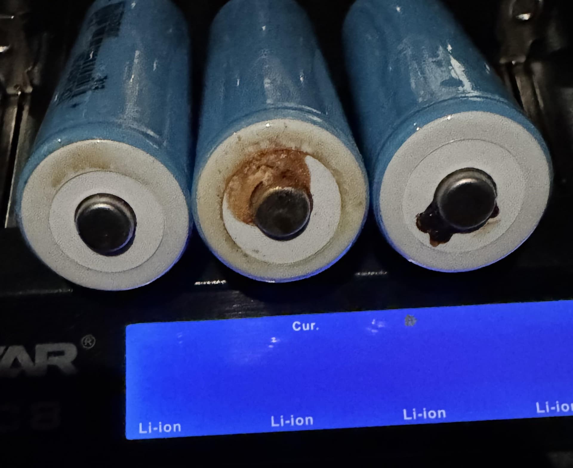

If these cells were bought from 18650batterystore they would say since the cells were ordered over 30 days there are no refunds even with defects like this. Marlene from there told me that verbatim based on 3 EVE 18650 cells I showed developed some leaking issue despite never being used. They were all in the original box, in the 2 cell clamshell cases.
Strange thing is I placed a new order (12/14/25) a couple of days before I saw this issue with these older cells I bought almost 2 years from today exactly. She told me to check all the cells (of this new 12/14/25 order) and returns are ONLY within 30 days, but how many cells develop problems that soon? What happens 3 months from now if these new EVE 18650 flattop cells I just bought develop problems or show themselves to be defective? I’d be SOL is what I would be.

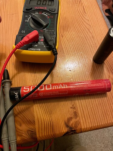

Really not worth starting another thread re self draining batteries. This proprietary battery from Acebeam has been replaced by the company so no problem there. But I thought it was the big Acebeam P20 that was drawing a bit.
To test, I fully charged this battery a couple of months ago and it hasn’t been used or stored in the light. Can’t take a pic and hold the probes, but it reads a totally flat 0.00V.
