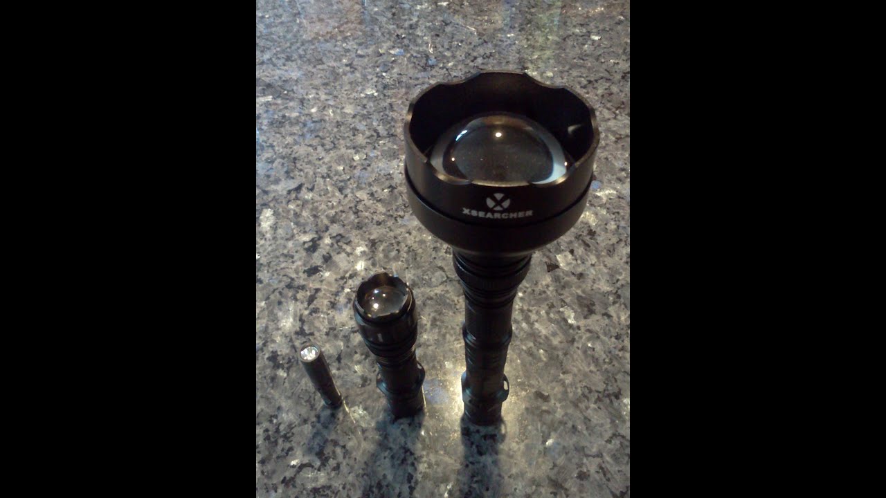

Sounds more like you need a laser with a focuser on it, to widen the beam a little. Most aspherics don't give a pencil beam. The aspheric beam tends to get larger, the farther out it goes. You can always try one of the 18650 aspheric zoomies, but I bet it won't fit your needs.

I would suggest modding the Convoy S2+ or the likes that have shorter reflector. Just change the reflector for a narrow spot or plain tight TIR optic from Carclo. Look for 20mm 10XXX series with the highest Cd/lm number for the led in question.

Maybe the most suitable choice in stock form is the Olight javelot or Maxtoch 2X. For a budget option: Courui big head, XP-G C8.
