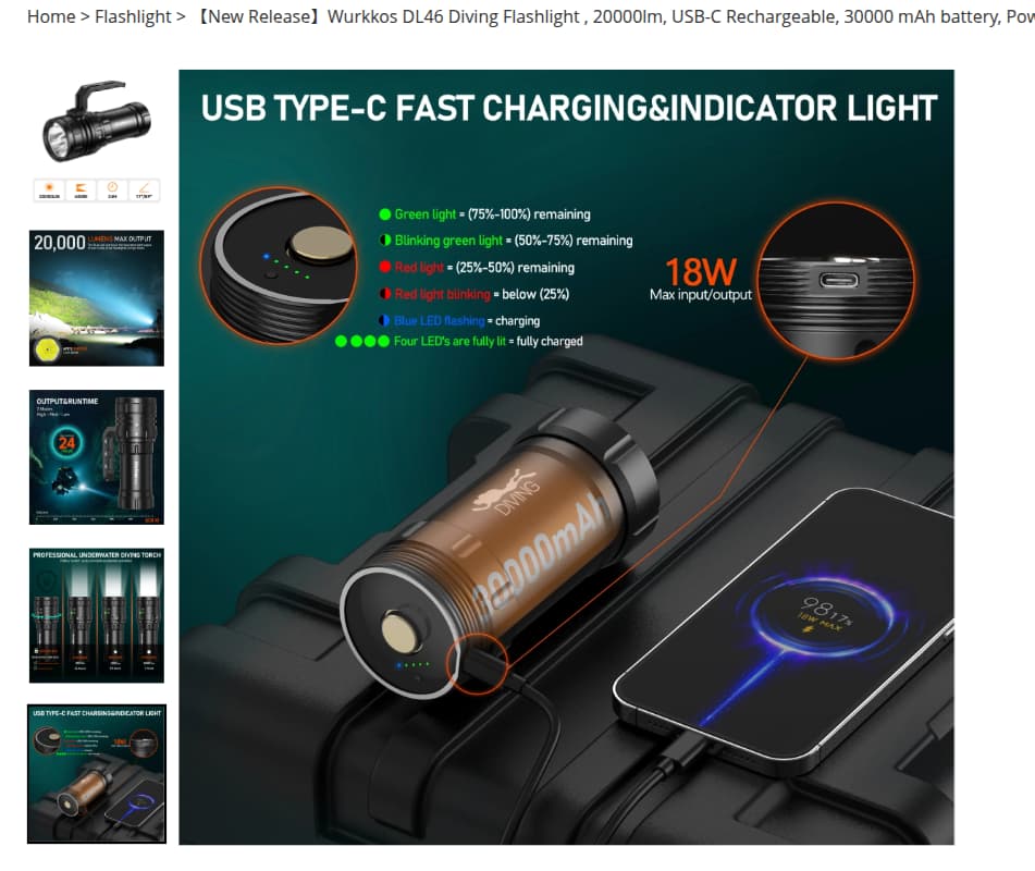

I note that the new Wurkkos DL46 diving light is listed as using a dedicated 46950 battery pack with integral USB C charging port and claims a maximum output of 20,000 Lumens. I hate to think what the initial current at turn-on is at 4.2V or lower.
Sorry for my VERY late reply!
Maybe I interpret it you wrong, but as you state it, I assume that you meant that the 46950 battery (not pack, it’s a single cell), has a intergral USB-C charging port.
From what I can tell on the image below (from Wurkkos their website) is that the charging port/implementation is part of the flashlights construction and therefore seperate from the 46950 itself:
Max. 18W in is a pretty low charging current for a 46950, which can handle way higher charging rates. Charging an empty battery will therefore take quite a while I expect.
In which way do you mean that?
46650’s can handle a seriously high discharge current. I’m not sure where Wurkkos source their 46950’s, but if you take the Liitokala/EVE 4695E discussed here in this topic, it has a maximum discharge current of 4C (so 120 amps), which I don’t expect the DL46 to come close to. Combine that with it being a diving light, which will also help to keep the light/body tube cooler and I don’t expect the 20000lm (at turn on) to be a real big problem for the 46950.

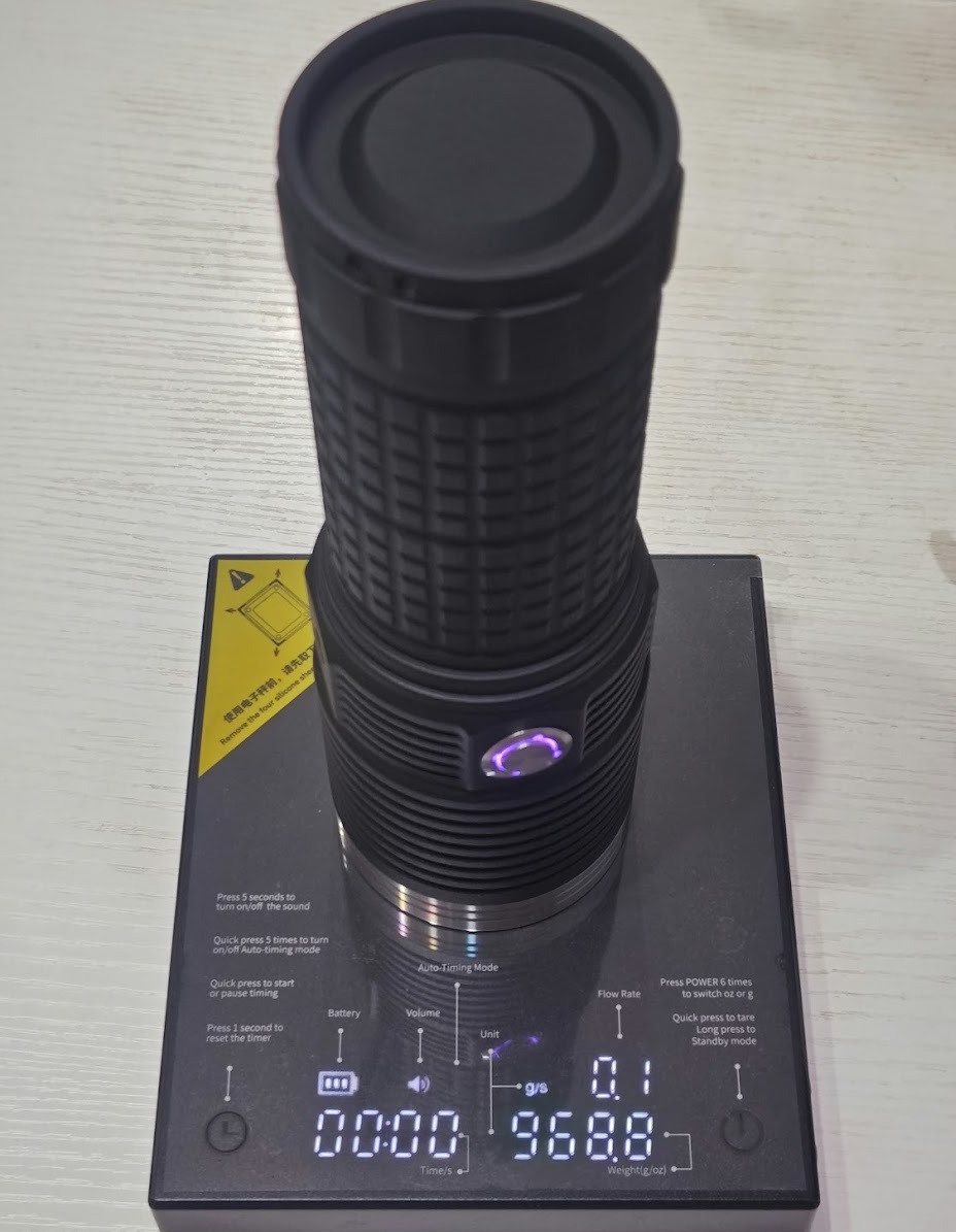

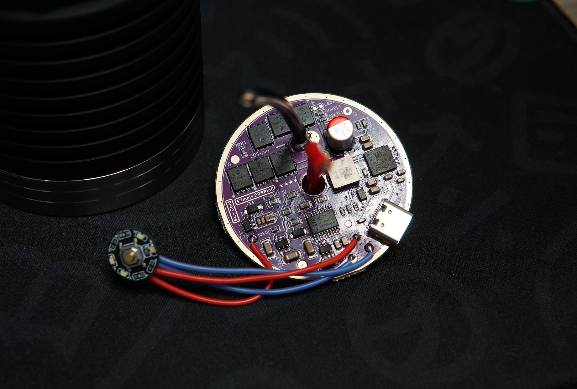

So, I’m playing with this host recently: DDH-D6E/46950 tube, cost 168 RMB on taobao.

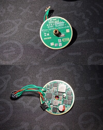

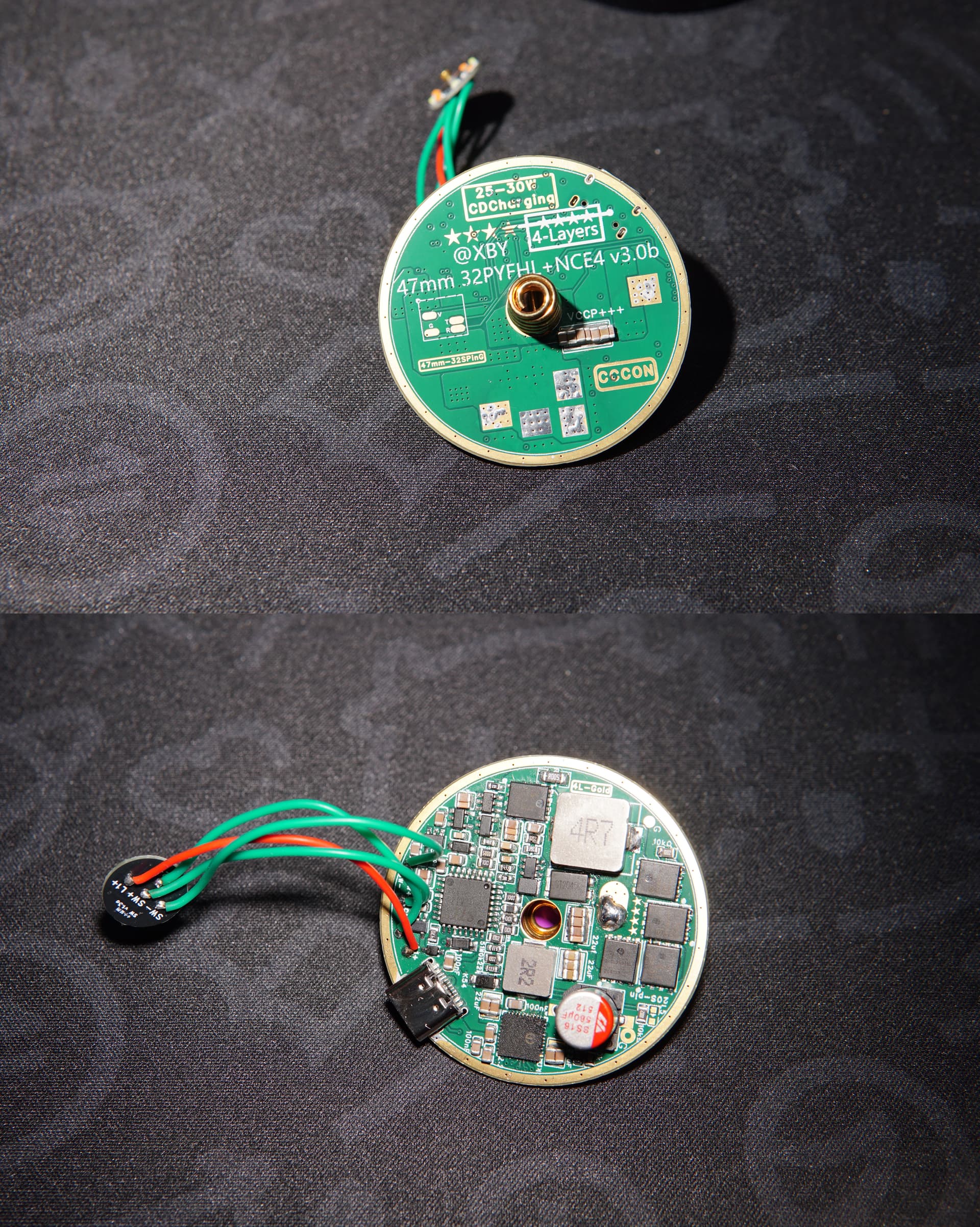

It was fitted with a 47mm XBY v2.2b FET driver capable of huge output, with USB charging and powerbank capabilities.
After a bit of exchange with the driver producer, he kindly provided a beta version of his latest Regulated +FET driver, XBY v3.0b for me to test! Out with the old, in with the new, in less than a month :grinning_face:

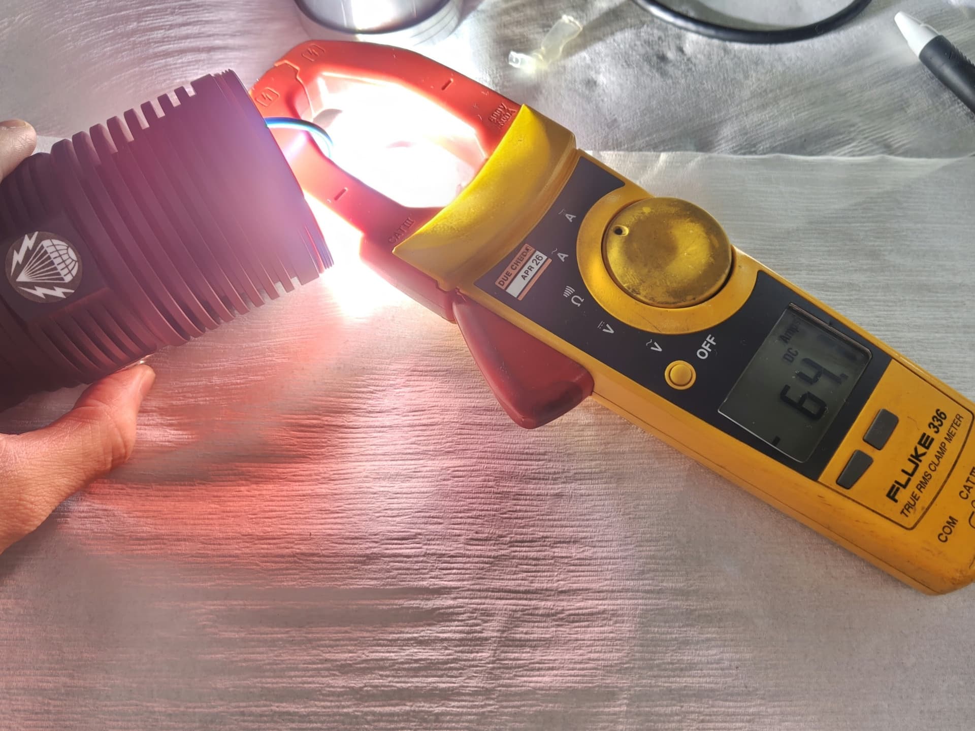

It does regulated 0.5A to 20A ramping or 6-stepped output. And on turbo,
it’s capable of pumping over 65A through the SPF55, that really put a smile on my face :smiling_face_with_sunglasses: The producer claimed that it’s capable of 100A of current if SFY55 or NDB160 is used, which is overwhelming imo, but impressive of course.

Awesome. Like a scaled up Nightwatch NI03S. Did you get any performance data like for output etc?I’d be interested to see if this would be an alternative to Nightwatch, which hasn’t been investing much in interesting lights lately.

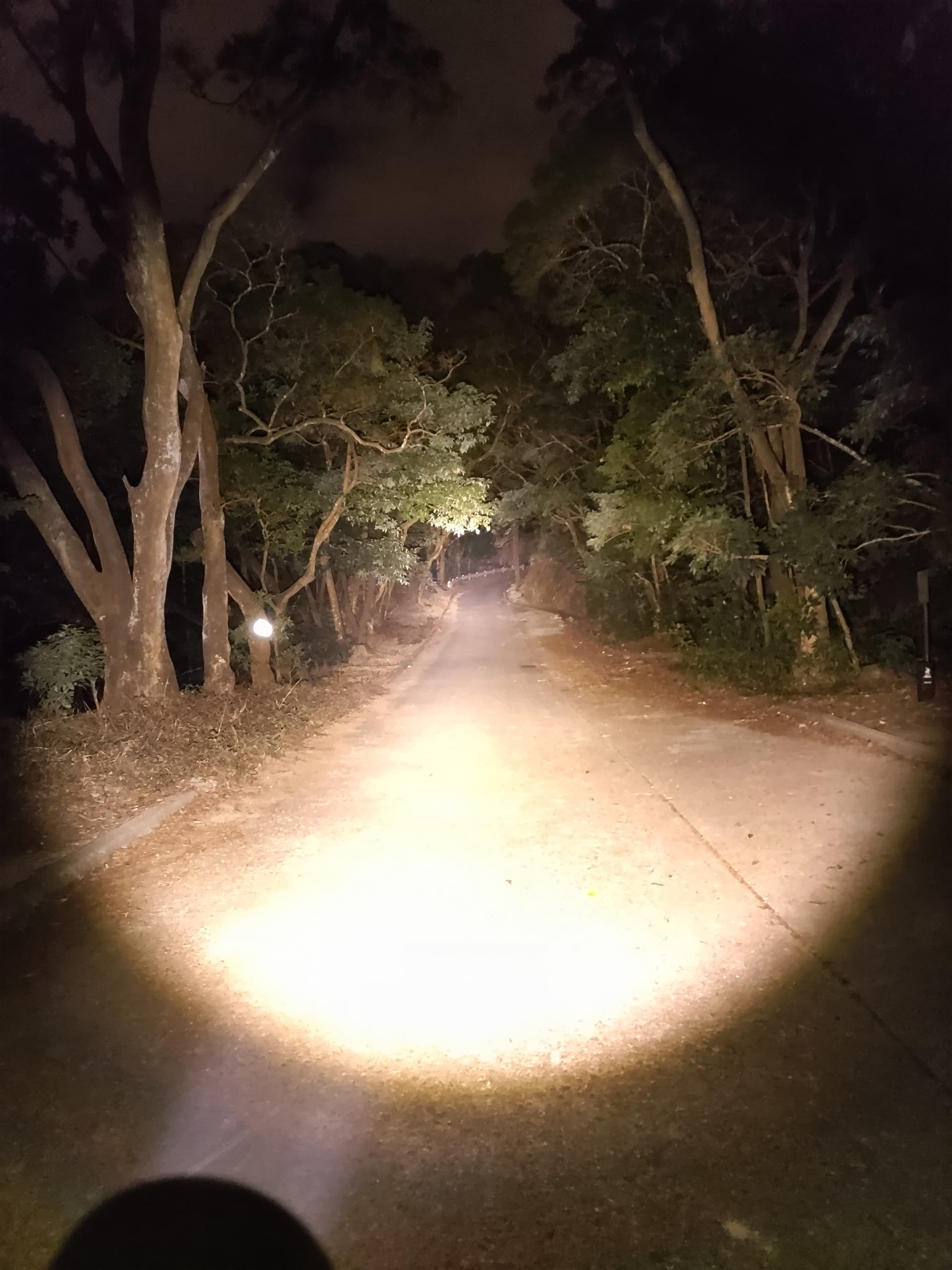

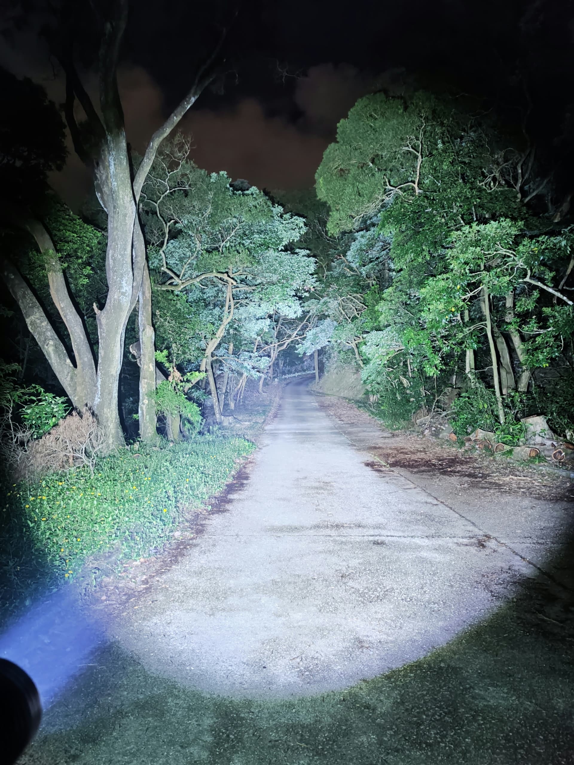

I don’t have any instruments for proper figures so, I went for some beamshots.
The first photo is..(you guess it :joy:) the D6E SFP55, full blast. The second photo for comparison is a M21C XHP70.3Hi 4000k “N4”, 6v8A turbo, taken earlier this year.
Camera set to 1/15s and ISO 3200.

The regulated 47mm driver is not open for sale, yet.
I originally bought the 47mm FET version(the purple one)(through some hardship) which was the only version available, alongside a 32mm one. We talked and he asked for some feedback on the driver. I told him “a regulated version would really be appreciated.” and he happened to have a regulated 47mm design in the pipeline, that ends up in my d6e now. Hopefully he’ll produce a refined version for sale very soon.
