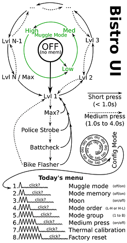

The firmware is experimental, so be careful! But it seems to work for me. The UI is the same as in the original Bistro:
