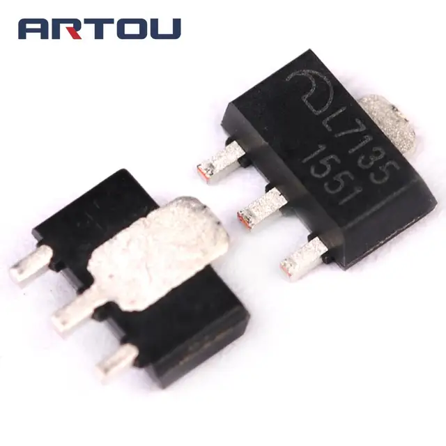

For one, Mtn uses 380 mA 7135 regulator. Newer Banggood BLF A6 uses this:
