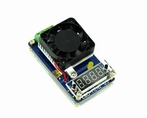

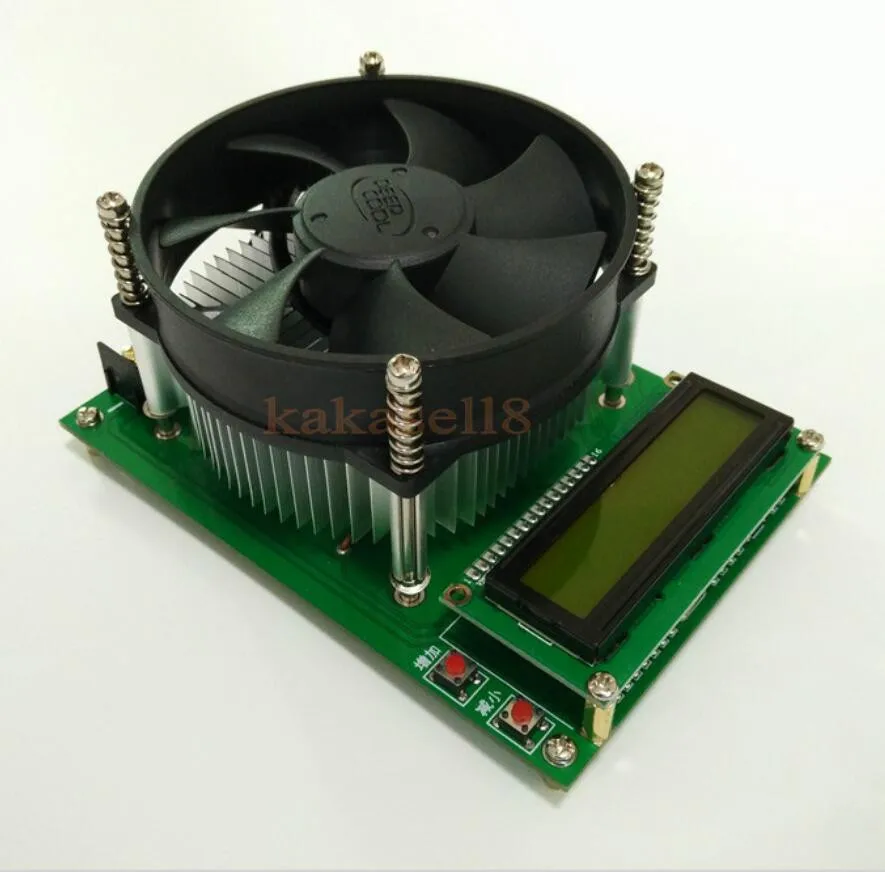

Any budget suggestions for discharge testing above 1 amp. Querying Ali shows some interesting options. Has anyone used either of these 10 amp testers (Links in pictures):
EDIT: HKJ has a great review of the 60w tester (pictured on the right above) here. I have a mini review of the 150w unit (pictured on the left above) here.
The first one above is about $28 and supposed to handle up to 150 watts. The second is about $18 and is supposed to handle up to 60 watts.
The first one has the bolded instruction below. Would one be able to use 2 separate PSU's connected to the same wall outlet to be adequately independent? Maybe the cell or cells being tested are the "Load". Any one know what the below means?
"1, power adapter: DC12V, with special attention to the load power supply and power supply must be 2 independent power supply, can not be shared"
This means the load and the 12V power supply are not allowed to be using the same ground.
So you need 12V to operate the device and another power supply to drive the load test.
In your case the batteries would be the 2. power supply.
Basically its identical to a LED driver, if you connect ground to the LED minus you shortcut the driver
Its a lowside driver so there is a regulated resistor between the load and ground, so the 2. ground on the discharged battery/LED you run is floating on a higher voltage than the power supply ground
It looks like the load tester uses seperate power and voltage contacts for the load so the voltage readings are more accurate as in normal analyzing chargers
Thanks Lexel. The second unit looks more than adequate (30v and 10a), but I went ahead and ordered the first unit that can discharge up to 60v and 10A. I think I ordered from a different vendor for a slightly lower cost.

I expect to receive the 150w unit tomorrow. I won’t be able to post any thing even remotely like a HKJ caliber review, but I’ll measure and post what I can.
