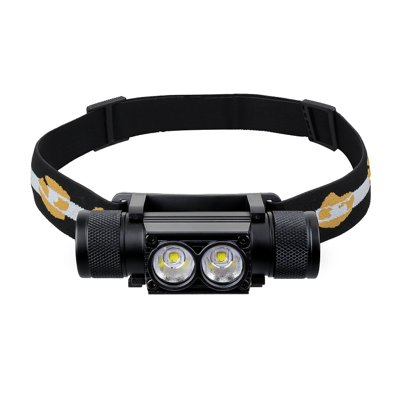

Here is a budget find:
Not 100% sure what to believe, but it sports two SST40 in OP reflectors at 5000K and cd/lm seems to be around 10. Should do what my friend wants…
I saw the beam distance in yards and I come to same calculated result as you… (we are both assuming it’s to 0.25lux, as ANSI should be).
I’m sceptical of 10cd/lm however. There isn’t much hard data I could find, but this review by @tactical_grizzly puts the 5000k, single LHD351D at 1.18cd/lm…
Now I know these are different LEDs, but the reflector format is the same, I don’t have any lights with the LHD351D or the SST-40 so I honestly don’t know if an SST-40 could be 10x as throwy as the LHD351D? I’d be more confident to say the Wurkkos specs are wrong …
