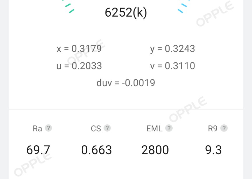

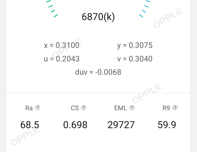

Measured my HK08/with Opple LM4 - it is below BBL! It is indeed not green, but kind of blue due to the high CCT. (Note: Ignore R9, it varies randomly.)
Turbo (identical at top ramp):
Bottom ramp:

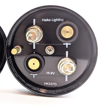

Am I looking at the right light? It’s definitely series. In the 1lumen review of the hk08 you can see where it says 16.8V on the inside of the tailcap
haikelite-hk08-closeup-1-1024x771~2
Is that the right one?
Yes. SFH43 are the LED, not the battery. I was saying that the driver could be a boost driver (i.e. boosting voltage from 4S voltage) if the LEDs were all in series (in which case the driver would need to produce 24V from 16V to run each LED at 3V).
Personally I doubt it is a boost driver though; the X75 uses 6V or 12V LEDs (XHP70 come in both and I’m not sure which of the two) while the HK08 uses 3V LEDs.
