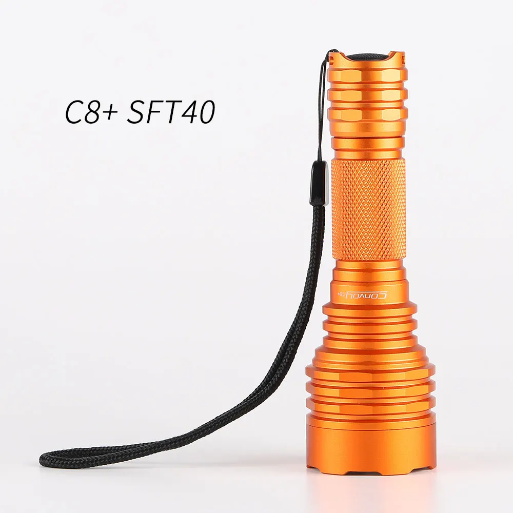

Thanks to everyone for the informed feedback. Would anyone be able to provide a link to Simon’s listing with the suggested option: C8+ with 8 AMP SFT40-W? I’m not picky on the color; but since I already have the MAO (White’ish) version (CSLNM1), I’d prefer a different color. Thanks again; take care & GOD BLESS!
$23.01 | Convoy C8+ with luminus SFT40 6500K 5000K,copper DTP board and ar-coated inside,18650 flashlight
Pick a color:
Thank you kindly. Do I specify between the following:
5amps linear constant current, 12groups 8amps buck constant current
I just want to be certain I get exactly what you folks recommended: SFT40- W; 8 AMP BUCK Driver; 12 Groups
And just to confirm; the approximate specs would be: upwards of 2000 lumens (turbo) with still being a decent thrower; and what I’m assuming would be fairly high candela. (>200K)
Yes, thank you. I was looking for those options; I didn’t realize I first needed to “add to cart.” I thought it would allow the specific selections b4 adding to cart. THANKS AGAIN INeedMoreLumens! You’ve really helped me navigate this quite well. I’ ve basically been a Streamlight/OLight/Maglite guy up to this point; but the MAO C8+ I got a few months back impressed me. (Price point especially) Do now I get my 2nd one! I have the MAO on an AR at the moment.
