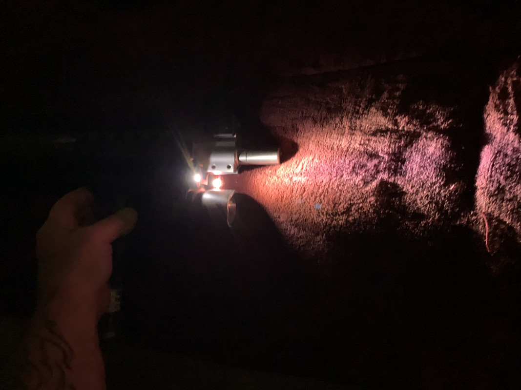

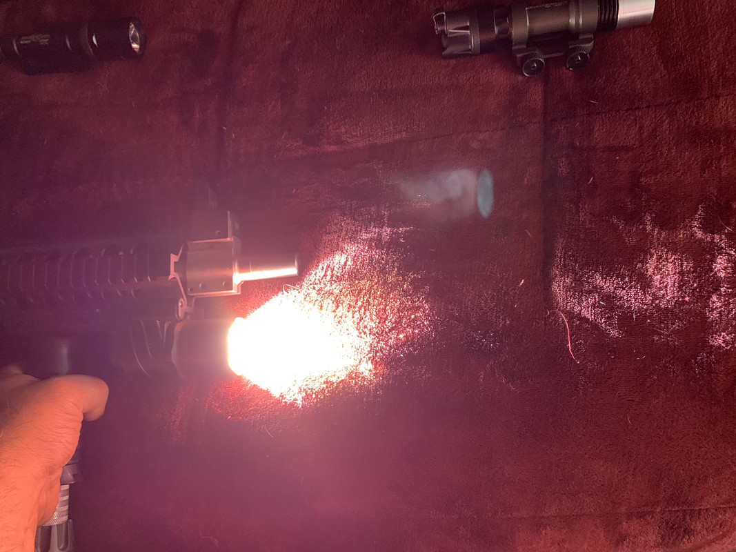

I much prefer the Vertical 900A with Navigation LED’s and the XHP70 … all my lights are Fwd/Momentary switched, modded and potted and operational for over 6 years now, no issues. I do have the option of running a pressure pad…on most of them, but then these are not really meant for Hunting…so I don’t chance it, though the Surefire is a dual switch, even if you loose the pig tail…it still can be button activated…
. Navigation lights…
. Main Light…
