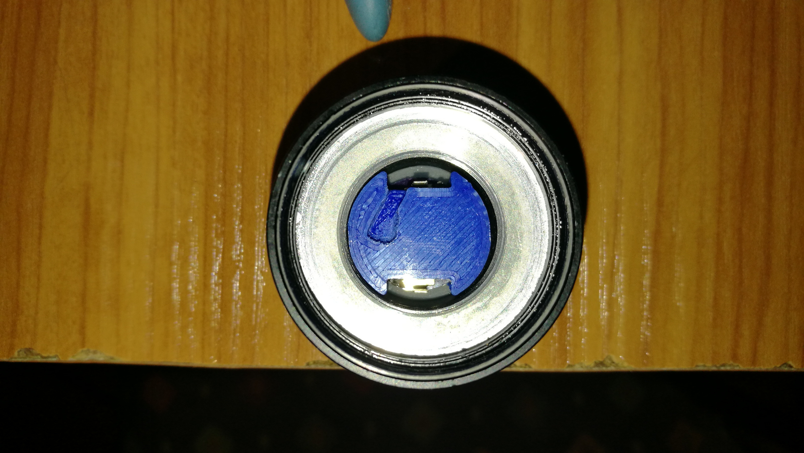

I hate forward switches most of the time when I only have the clicky to operate a flashlight. So I decided to put in a reverse clicky in my L2. The most commin is the Omten 1288 but it is much shorter than the original forward clicky in the L2. I also want to use a rev 5.1 lighted tailcap ring by PD68 so I designed a spacer to pur on switch PCB under the Omten 1288 to raise it as high as the original switch. I made a cutout to clear the resistors on the bottom of the ring PCB and If somebody wants to use PD68’s high amp switch board I also made place for a spring bypass wire on the bottom side of spacer if the wire goes through the switch PCB. I wil 3D print it and try it soon.
Here is the link for the spacer if somebody wants to print it.
EDIT: It will be in my heat colored L2 which now has an SST40 and TA OTSM driver. It has the stoch switch now but it pulls 9,5A and puts out 2226 lumens. And has 172 Kcd intensity and throws 830m.
It has useful size hot spot and The L2 host only gets hot after 5 minutes in turbo.
And I printed and test fitted the Omten 1288 reverse clicky adapter in the L2 tailcap. The wire groove not perfect but if somebody want to download the model file I corrected it. The high amp board needs a little grinding because it has a little pocket in the retaining ring and a little bit too large. Otherwise it fits nicely and the switch feel is good.
Very cool indeed! :+1: Wouldn’t mind having a few of them myself!
