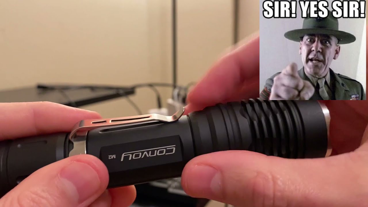

I carry mine everyday. I have it set up with a forward clicky and rubber cigar grip. I can’t agree with you more on so many points in the video. Most of all, how I think this is the best Convoy, and the only one I consider a must have.
My particular sample I’ve built myself and have continually modified over time. Initially with the CSLNM1 and the 5A Convoy driver and stock lens, I was getting 87kcd or so. Now I’ve changed it up to single mode (driverless) direct drive running the new Osram HHL532 + a UCL lens and threw in a forward clicky and the rubber cigar grip from my G25C2. It’s now making 100kcd at turn on with a full cell. Sits at ~92kcd for a long time before the it starts to fall off with the draining cell. I EDC it without a clip and carry it loose in my pocket.
I’m curious how they got the LED to focus. I would love to see a teardown of your sample. I had to do extensive filing of the reflector lip/flange (large end) so that it would sit low enough. Might be a batch variation or maybe they use a thicker MCPCB? If I build another, I’ll be shimming the MCPCB because filing the reflector is tedious and risky.
If you want know my setup for the forward clicky mod let me know.

I used flush cutters to remove the nub inside the tailcap cover. Switch w/ pcb is a spare from a V11R, which needed the slightest filing of the pcb’s OD to fit inside the brass ring. Special thing about this switch board is that the PCB is 1.0mm vs the typ 1.5mm. I bought a FC from MTNe and the switch itself measures out identically, so additional filing/sanding of the washer to compensate for that .5mm is possible, though maybe not necessary because when installed the brass ring is countersunk by 0.22mm and I don’t think it interferes with the battery tube if it’s a bit proud.
Last note is that I had to ream the washer ID to fit over the ‘tower’ portion of the switch.
Chadvone, I bought that Doberman from you hoping to utilize it’s driver and UI to displace this M2 from my EDC position, but so far I haven’t built up the courage to crack into it. There is virtually no way to get the reflector out of the Doberman without drilling a hole in the side of the head or maybe getting the driver out first somehow. So for now, this Convoy reigns as ultimate EDC tacticool thrower.
