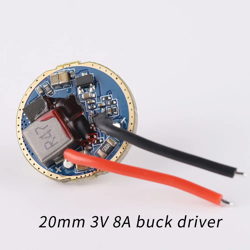

Simon now offers a 20mm 3V 8A driver so there would be no need for the 17mm to 20mm adapter:
20mm 3V 8A buck driver 12groups for SFT40 KW CULPM1.TG

This is the driver that I chose.
However I’m not sure what mcpcb to chose.

A SFT40 in a M21A with a 8A driver like @NeutralFan suggested will definitely throw.
In fact it would be hard to beat in that host!
The 20mm MTN20DDm you mentioned uses a DD(Direct Drive) FET, that paired with most 21700 batteries will provide too much current for all throwy Emitters I can think of, including the SFT40.

Is the right driver? 20mm 3V 8A buck driver 12groups for SFT40 KW
Yes, that and this one on 20mm MCPCB:

It’s a not regulated driver with unknown current to the emitter.
XP-L HI is pretty bad at handling high current.
