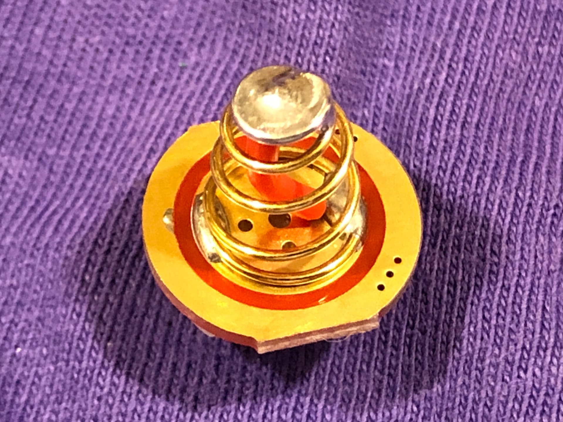

And that reminds me, you may want to bypass the switch spring unless it comes with a newer copper spring that Convoy now has. In the past, anything over 3 amps needed a bypass, but apparently the current Convoy spring can handle up to 10 amps.

Agreed, although the copper ones are harder to bypass if you try to cover the entire end of the spring with a solder blob since the hole is much larger now:
True. I don’t try to cover the whole top of the spring anyways. Lately I’ve been doing 1 of 2 things. And idk if either of these are more effective than any other, none of this is scientific lol. I’m just trying stuff.
Either i desolder the omten switch, put that aside, throw the PCB on my reflowing hot plate, heat it to take the spring off. Then I’ll put together a double spring, either with two of the same sized convoy springs or with a slightly smaller spring, either Hank’s little beryllium copper ones, or with kaidomain’s gold plated phosphor bronze, spring #30384. Both are slightly thicker than the convoy springs too. Either spring by itself usually isnt big enough but sometimes works. Then ill rub a little solder paste on the bottoms and reflow them back on the board. Then solder the switch back on. Nice clean double spring.
Or I’ll use 20awg and just sand and polish it down flush, outdoors with a p100 respirator, cuz lead. Or if it’s a big spring I’ll use 18awg cuz you can kind of spread the strands over the spring like a web and cover more of the whole top of the spring that way. And then sand+polish that flat too.
And for the top spring on the 12a fet driver I do solder on copper braid to the driver spring because I did have the top spring melt on that driver, and there’s no components driver side, but I don’t want to desolder something on the other side. And then I just check on the braid frequently and don’t leave a cell in the light.

I usually just bypass with the same AWG as the driver, which is typically 22 gauge. That seems to be the norm with the Convoy and MTN drivers. And since the bypass wire is shorter, the limiting factor is then with the driver leads.
Left to right all on convoy tailcap pcb’s- current convoy spring, convoy+kaidomain double spring, Hank’s BeCu spring
But it doesn’t work like that. Total resistance is the sum of all individual resistances, Rtotal=R1+R2+R3…, you know that. There’s no one limiting factor.
