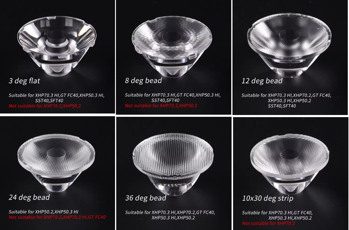

Would 3, 8, 12 (the original?), 24, and 36 deg. TIR optics be a drop-in for the Convoy M21H with XHP70.3 HI R9050 5000K, or does it require some fiddling such as centering etc? Also, the front glass in this flashlight seems to be AR coated - does it matter what kind of coating it is (green, purple) and do I have a choice? And the last one: there are two SS extra bezel types - is a SS bezel worth it and if so, is one type better for some reason than another?

I tried 3 and 8 deg and stayed with 8. Although it creates one ring in the beam it’s at the very outter edge of the spill and it doesn’t bother me. Also 8 deg TIR has nice petal bead’s texture.

The 24° doesn’t really work with the 70.3. I put one in mine and it slightly crushed a corner of the led.
Is it just 24° or any wider than stock?
Just the 24.
Here’s info from Convoy’s Aliexpress store
There are two types of issues: incompatibility with dommed emitters, incompatibility with 7070 emitters

After experimenting with M21H and some TIR lenses, along with my previous experience modding my M21F for the same TIRs, I’ve come to the conclusion that those 35mm TIRs work best when there is a thin gasket between the TIR and the emitter, especially XHP70.3 HI. It focuses the light better, creating a tighter hotspot. However this is not possible for M21H without some modding since the depth of the head was designed to fit the TIRs without any gasket.
By default the emitter sits too deep into the TIR and the focusing is not optimum.
Hm, I have this light in white with the less serrated SS Bezel and FC40 - I was using the 24° lens that is incompatible with the LED til now, because the Convoy website has zero clue that they damage the LED.
THankfully I also ordered the 36° one that I will use from now on. Thanks!
Shame, shame, 24° is perfect for me…
Or I will just keep using it and not tighten the bezel like an ork.
@Simon_Mao Could you please include the picture above in your website-listing?
