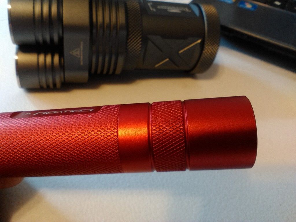

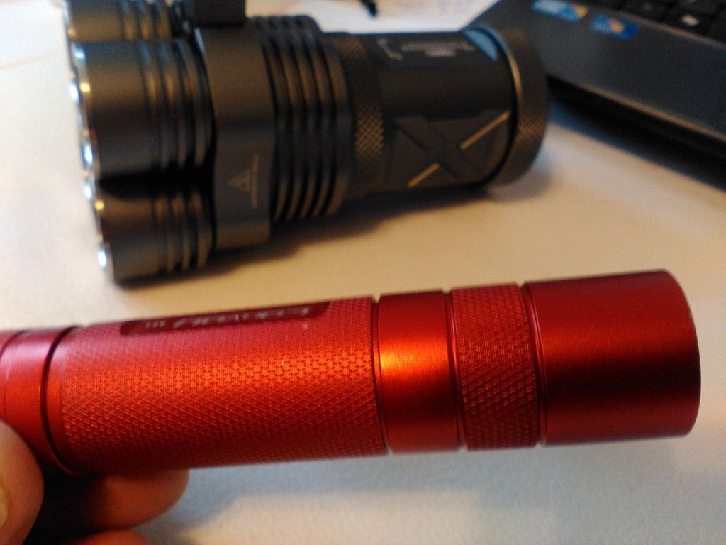

The .060” gap = 1.53mm
Swapping the lens from the stock 1.5mm thick to the KD 1.0mm would reduce the gap down to 1.03mm (.040”)
I unscrewed the head on my S2+ to a .040”/1.03mm gap and it is hardly noticable, I could easily live with that, in fact it exactly matches the grooves above and below the knurled portion of the head (those grooves are exactly .040”) and actually makes the light look better IMO.
With gap:
Without gap:
Thanks for checking and measuring this. With the thinner lens it appears the S2 deep SMO reflector will work in the S2+ with no further modification, at least for me since I don’t mind the .040” gap.
Now I have a game plan. Once I receive the parts I’ll try them in my S2+ to confirm. If everything works out I’ll build my Desert Tan S2+ with XPL HI in the S2 deep SMO reflector, FET + 7135 w/guppydrv DUAL.
