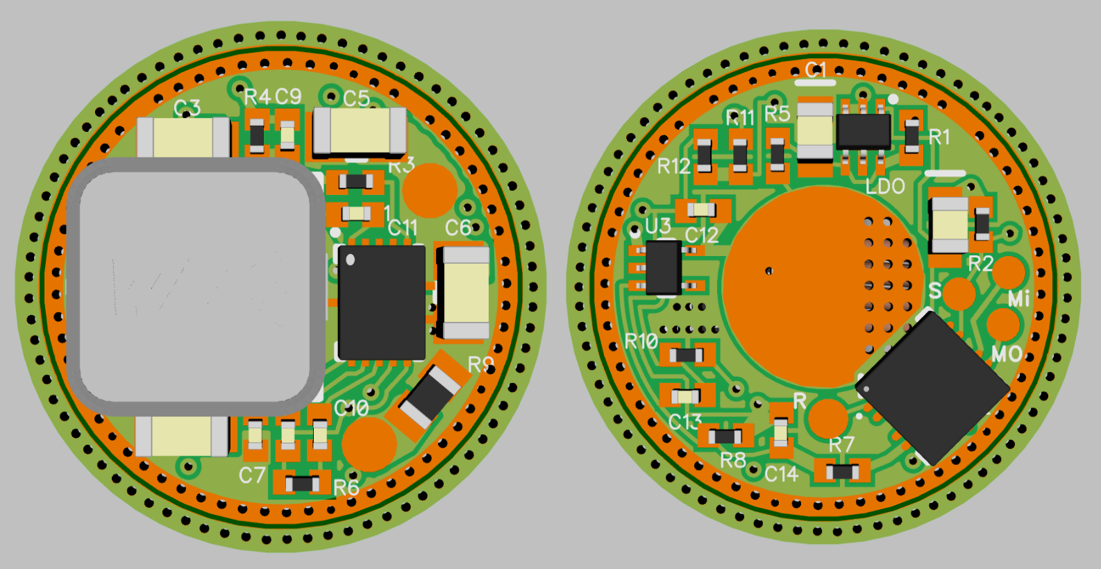

Also, I’m curious… What driver do you plan on using? S-series Convoys take a 17mm driver and I haven’t really come across a 17mm 12v driver yet.
17mm 6/12V Bistro/Narsil driver is in progress but likely over a month from being sold
