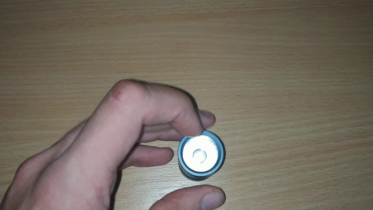

I have feeling that this will be very stupid question, but
I have just got new s21a from simon
is it OK if the light head is ratling? whole inside part is moving and glass is free to rotate and move…
Shouldn't do that.
(1) Make sure the pill is screwed all the way down. There are two notches on the pill - you can use needle-nose pliers to screw it all the way down.
(2) Make sure the O-ring wasn't left out (behind the lens).
