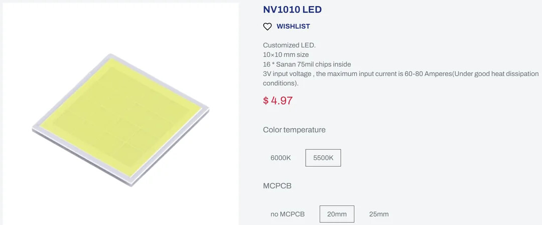

Some details about the new NV1010 LED:
10×10 mm, 3V, 16-die package, rated 1120 lm typical at 2 A, with the graph pointing to roughly 3300 lm at 6 A and around 5300 lm at 10 A.
The 2 A test point also looks pretty efficient: 1120 lm at a typical 2.88 V works out to about 5.76 W in, or roughly 194 lm/W. On paper this looks like a cool white, low CRI (Ra 70), output oriented LED with low Vf.
The datasheet says 30 A absolute max, while the Convoy listing mentions 60–80 A under good cooling :fire:
Link: NV1010 LED - Convoy flashlight.
That sounds promising.
A suitable host for a 60-80A LED is probably going to be a 3x21 with a bigger head for more cooling? Ideal would be a little fan on it…
I very much hope that this LED will be available with a bit lower CCT, around 5000-5500 maybe, to still have that outstanding brightness but no blue white which I expect this to be.
There’s already 5500K option added today
So Simon is now able to read my thoughts, huh? :clown_face:
Edit: Interesting, the CCT Options are now 6000K and 5500K - so close together, other suppliers wouldn’t even bother to seperate them.
Would be interesting if these have different phosphors or if it’s just the binning but the same phosphor.

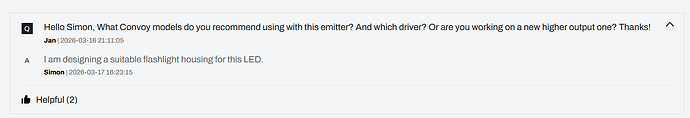

What lights is Simon going to put that monster in? (17mm 20 amp driver)
Interesting emitter, somewhat similar to ChangDa SFP55, although the chips are different. (I don’t remember which chips are used by ChangDa, could be AoYang or something like that, definitely not Sanan.)
The font and style of this datasheet looks a little bit like the ones from Lumenpioneer, but this is pure speculation.
At 20 Amps the light flux could be around 10000 lm or even more, maybe at 30 A 13000 lm and on 60 A (the highest what I could test :smiley: ) there could be 17000 lm possible. The luminance should be low at lower currents since almost the complete footprint is LES with approx 50-60 mm^2, which would equal to roughly 110-135 cd/mm^2 at 60 A and estimated 17000 lm.
To avoid confusion: these numbers are estimates. They could be higher or lower.
Phosphor is standard YAG:Ce3+, so no surprises there. What makes me wonder is the relatively low Tj of only 125 °C (most other emitters have 150 °C), which could limit the maximum performance to some extent.
