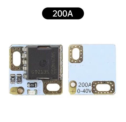

And the “driver” for it :rofl:

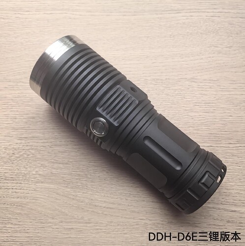

But, to mix things up, DDH now offers a very good looking 3x21700 tube.
Can we call that a driver tho :joy:
Hahahaha, hilarious
All you need is a momentary switch to turn it on. Yeah, it’s a driver :rofl::rofl::rofl::rofl: also has a tiny led on it so you can see it’s on . Definitely a driver

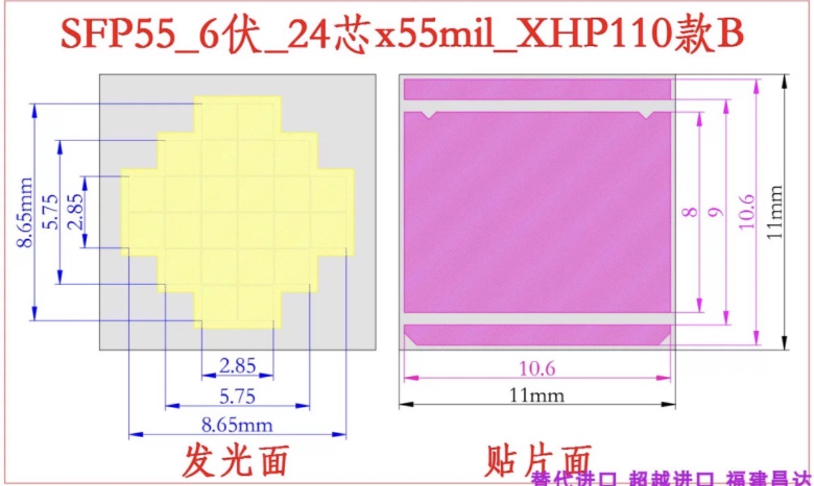

@koef3 I don’t know if you’ve measured/calculated the illuminated area of the SFP55?
If not: do you know if the individual LED chips of the SFH55 and SFP55 are the same (size)?
That way I could (roughly) calculate/estimate the illuminated area of the SFP55. If indeed the same, I roughly come to 49,5-49,9 sq mm vs the 31,9 sq mm you measured for the SFH55.
I am currently not at home and have no access to LEDs and equipment. Please measure the LES by yourself since the dimensions are mentioned in the test.
I’m sorry, I missed the part about the 11x11mm package size, sorry for asking/bothering you!
Yes, the 55 means the individual chips are 55mil.

edit: sorry, misunderstood your question… yes, the individual LED chips are same size, as @INeedMoreLumens correctly pointed out. Only the amount of chips varies between the two emitters…
