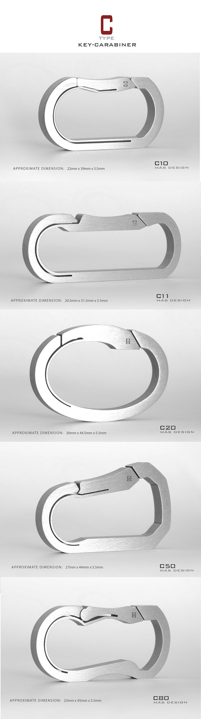

My first thought; would the spring pinch you as the hinge opens?
I quite like the C10 and C20 designs but they don’t seem as handy as the Niteize S-Biner. Different applications I expect.

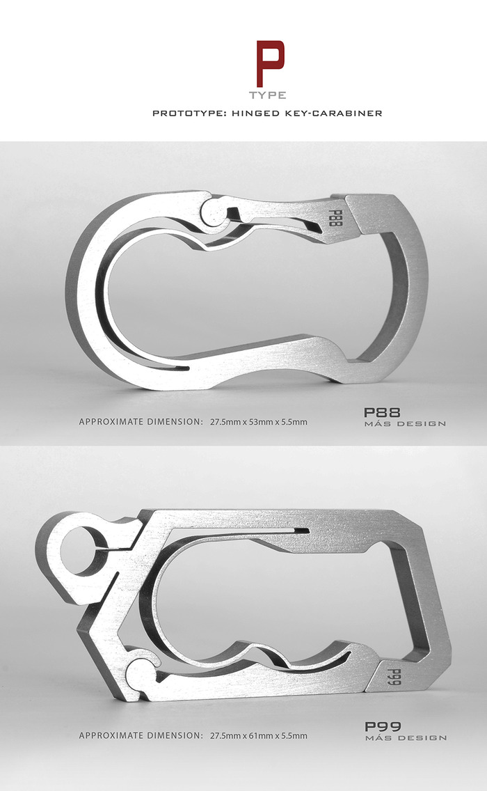

My first thought was "what a stupid design", especially the first one. When something hangs from it the spring will be compressed and pull the latch open. It doesn't look all that trustworthy. I will give it kudos for the novel design at least. I just don't see any advantage to it from a traditional carabiner. None at all.
This design looks far more practical. At least they do say that all their caribiners are designed for low weight use like a set of keys and suck. The design of this one, with minimal gap between the spring and body, means that the latch won't get pulled open and the spring has a far less chance of getting deformed or twisted.
Yeah seems a bit form over function, but I like the idea. Giving the C10 a try. Already have a few niteize carabiners, we’ll see how it compares haha.

Nice! I like the C10 the most out of all of them.

It's a nice idea, but the edges are too sharp, there are no capacity ratings, and weights of the carabiners are not provided. That's too bad. I could use good, small and strong carabiners.
I’m torn. I have an obsession with titanium, but these seem over designed and ugly. I understand the design, I know that smaller titanium clips that use the S-Biner style of latch have issues with the latch falling apart. I’d rather see some sort of spring loaded locking collar that you have to manually close.
