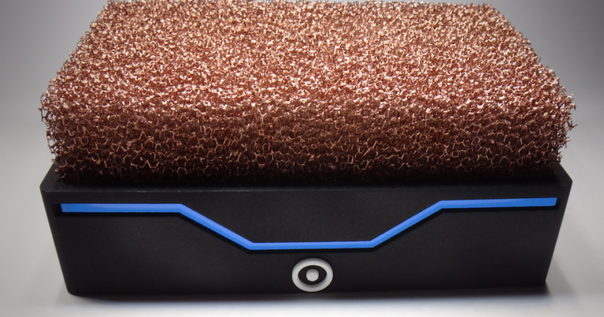

That computer uses,
Intel quad-core i7-4785T 2.2 GHz processor @ 35w
Integrated NVIDIA GTX 760 graphics, from 100w to 150w, depending on make and how hard driven, (actual card from Nvidia is 170w)
It is keeping 185w down to 50c at the surface.
6” x 4” x 1.5” = 36 cubic inches plus the copper plate it is fastened to.
185 / 36 = close enough to 5, so 1 cubic inch for every 5w
If the flashlight is a moderate 10w, it would require 2 qubic inch of the “foam” soldered to an all copper one piece pill/head with a copper star,
A copper base, which is in direct contact with the CPU and GPU via thermal paste, forms the top of the chassis and absorbs heat and releases it evenly to the copper foam on top.
The Silent Power creators claim that the circulation of air through the foam is so efficient in dissipating heat that the exterior surface temperature never rises above 50° C (122° F) in normal use.
This is just to get it down to 50c which is considered a bit warm for flashlight use.
And every little knock or bump will compress the “foam” reducing its efectiveness.

I can see the computer turning black (tarnished) really fast, especially at warm temperatures.

You have to remember that the foam is not closed cell. Air will travel through it by mere convection. In a PC situation you won't need a fan to force air through it. Simply having vents in the pc housing will allow the airflow needed for air in the sponge to flow through naturally and escape.

The air may naturally flow on the surface or for 1-2mm deep but no more IMO.
To have a good cooling efficiency you need a big surface and a strong air flow. Natural convection will be very slow in that “sponge”. Maybe that I’m wrong, but my physics knowledge tells me this won’t be very efficient. Time will tell.
copper sponge vs filling void with AS5 or other TIM of choice. AS5 is not electrically conductive!
The Cu foam is hollow, it works via convection. Heat rises, cooler air flows in at lowest entry point. Only works if you have air space around the foam and exhaust & inlets in the case. It might work in a lantern style light but not so well in a handheld torch.
