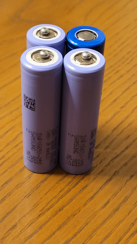

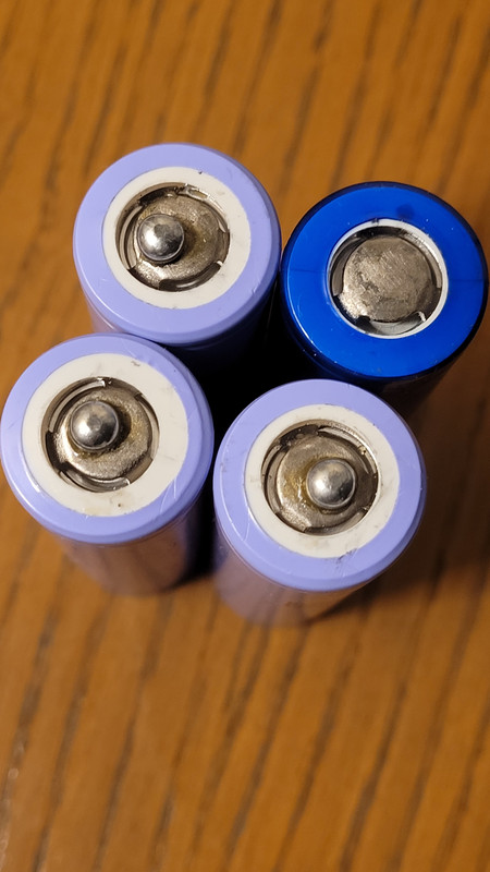

I will start with the Unacceptable.
He will remain nameless. He works for a battery dealer in the United states. He did two different types . The VTC5D are okay even though I had to do work on them.
The Samsung 25S are unacceptable to me. They look like a Sliver Beebee or a Ball bearing!
You will notice a rewrapped one in the photo that’s a flat top. That’s because the button top popped off the first time I put it in my battery carrier .
He claimed that the metal on that battery was different and the solder kept sticking to the iron??
He may be right, any of you guys have experience with button top on Samsung 25S?
I’m expecting the other Three to break off. I’m using it now with magnets on the negative end. It’s in a Four battery carrier. The Acebeam X65vn Mini.If/ When Another one breaks I’m not going to keep using magnets.
I give these SAMSUNG 25S an F

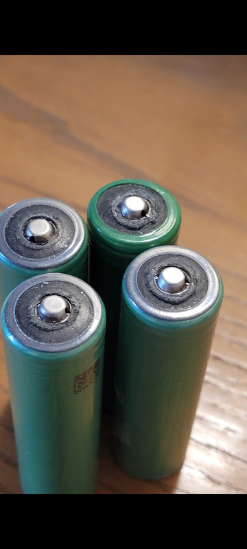

His VTC5D. He had two insulators on it with the top one being glued. It kept peeling off so I put another wrap on it. He said he does that for battery packs to make them safer?
I give them a C.
VTC5D

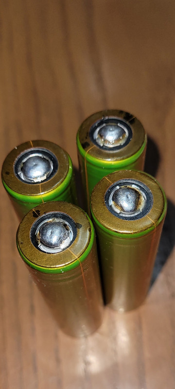

These were done by my friend and former neighbor Bob. He has Over 30 years experience soldering. He did a few dozen batteries for me these are the only pictures I have. I flattened the Dome with a file to make it even better connection.
Excellent job Bob. I give them an A+.

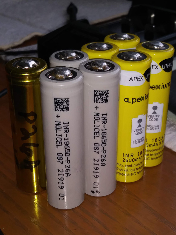

P26A and Apexium …Molicell P26A Rewraps?
