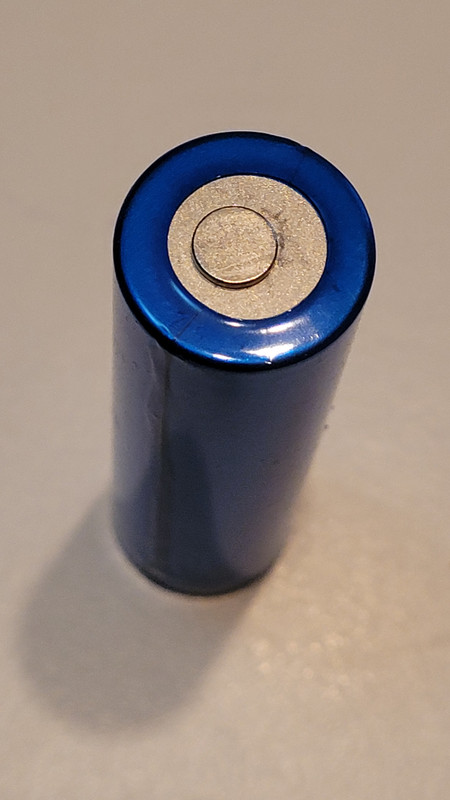

Issue resolved. Neodymium magnets adhere to the positive and negative end. I used the battery who had a broken solder blob to test it. Photos below
A member on here suggested to do that to confirm or deny that it was metal alloy that was a compatible with soldering.
He volunteered to fix them. :+1:
Be careful with the magnet on the positive side. It can easily cause a short when it slips under the white insulator ring.
No worries. I do have some knowledge.

When needed I have used magnets, what I did to stop any slips was put 3 very tiny dots of glue around the edge of the magnet (don’t use superglue it’s too thin and may go underneath) let it dry overnight and it’s all fine.

The reason I put those magnets on the 25S rewrap( that’s the blue rewrap one where his little baby button top fell off on first application into the carrier!) was to make sure that it was a metal that was compatible and conducive for soldering.
The guy who did those feeble mini BB tops told me he thought the 25s was a different metal than the VTC5D,30Q and others, and that’s why he was struggling.

Just one note on neodymium magnets.
They get less and less magnetic the higher the temperature. It mostly comes back when they cool back down. They aren’t supposed to be permanently damaged until past 80°C but a bunch of cycles to high temps and eventually they’ll be noticeably weaker. They also don’t like rapid heating and rapid cooling too much theyll eventually crack from the stress. They’re just really brittle in general.

Jeffgoldblum:
I’m not a fan of them in lights at all really, but they do fine. One thing I’ve been curious about is if there is a practical applicable limit to the current they can handle…don’t think anyone has tested that in the past in our circles. The typical N35 and N42 grades can start to lose their strength at as little at 45°C and as the temp goes up they lose more and regain less…that 80°C is where it reaches curie temperature and the magnetism is permanently lost can cannot be recovered. The N52 adds a little temp resistance but not much, and they do have some special high heat grades, but again, not adding a lot. For our purposes we just don’t seem to see those temps in the circuit where it affects anything, other than some one-off incidents where there was a direct short (the kind that flattens springs and melts switches).
Some years ago I put a small disc magnet on an oil drain plug…was surprised when it seemed to lose some strength over a couple of oil changes, and then learned more about the temp resistances (that one had pretty much free flowing air on it, too). Swapped it with an N52 and it was good from there on out.
I forget which site now but I think it was KJ Magnetics that had some excellent resource articles on these, more in depth (good stuff about pull force and how that’s tested/rated, too).
