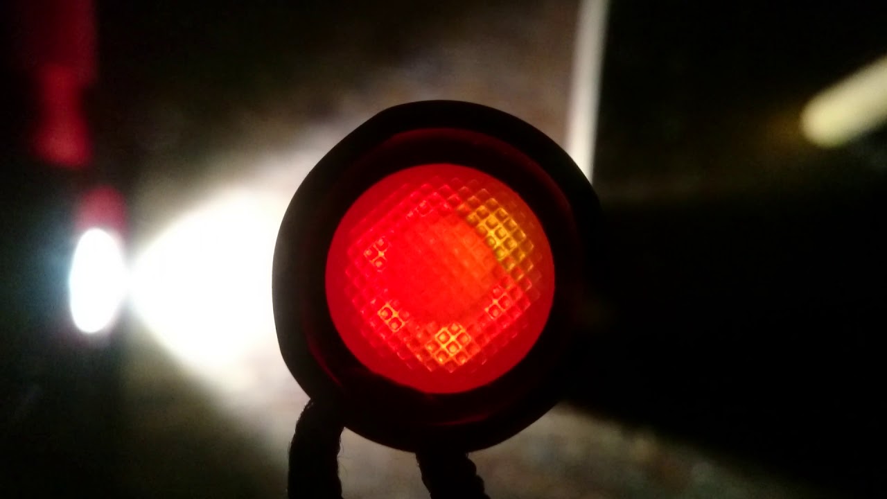

Maybe it just needs potted.
I want some of these generation two lighted tailcaps.
Maybe we can convince Richard to stock them in his store! ![]()
I haven’t looked in depth, but I thought EL wire required like 100-volt alternating current at about 1000 Hz? It would need an inverter and a serious voltage boost and the frequency would likely be audible… I don’t think it works at higher voltage or inaudible frequencies, does it?
I thought it sounded like a fun addition to some projects… until I found out it required alternating current.
The only thing I can think of for some semblance of practicality is a wider body that can house two separate circuits. Kind of like a Spy 007. We could use 2x CR2’s to power the inverter, and maybe a 16650 powering the LED side.
No, it wouldn’t be ideal, but it sure would be attention-getting!
-D
