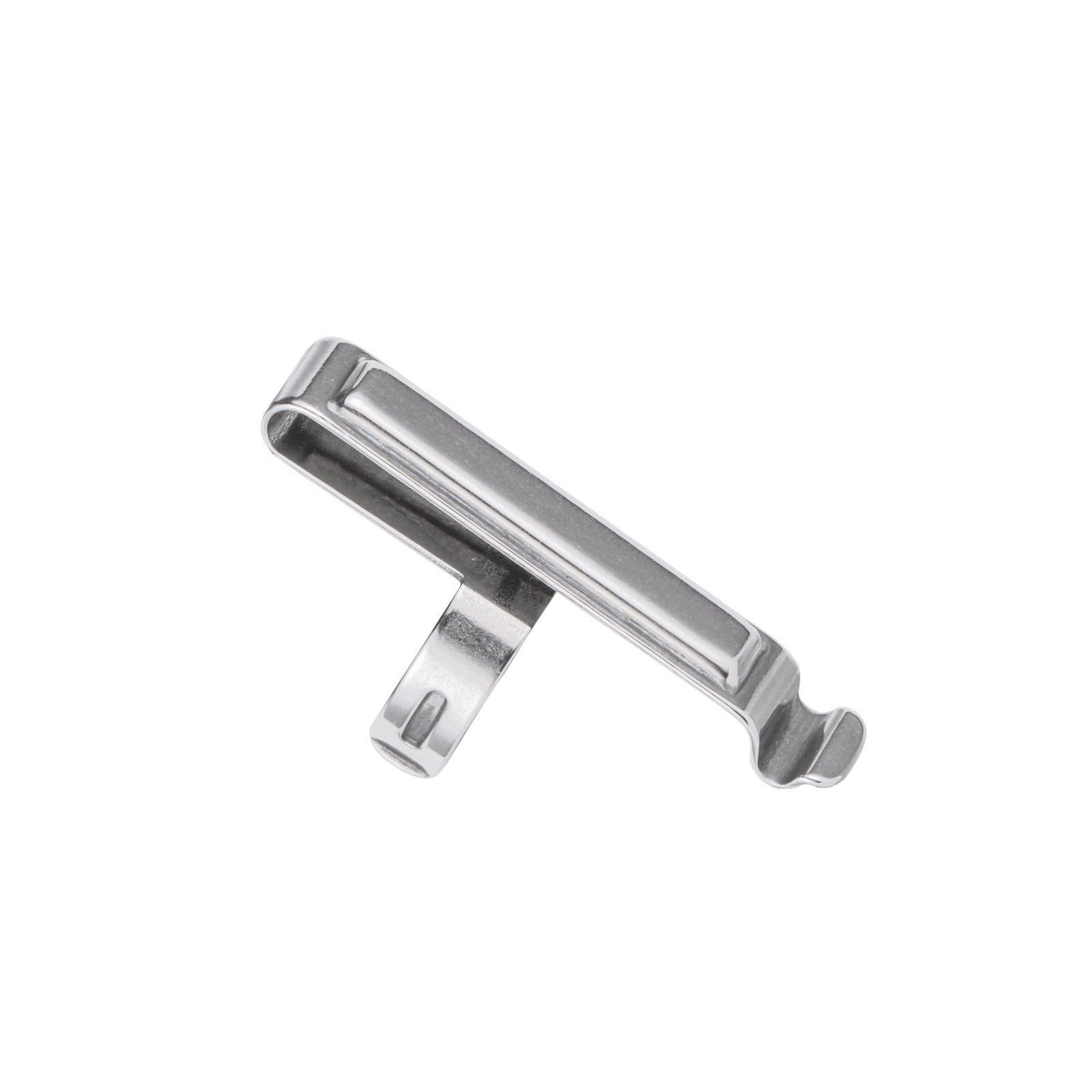

Rovyvon’s pocket clip being magnetic is really annoying, and they don’t seem to sell a non-magnetic one.
Anyone know if it’s possible to de-magnetise it? Amazon have demagnetisers for screws but I’m not sure they would work with something a bit bigger.

It looks like the clip from a Baton 3 should fit so I’m going to give that a try. My light is the A24 Ti gen2 (USB-C)

Ah, I looked at your clip.
The oven should work, or hold it over a gas flame. Rare earth are a fair bit more stubborn than that. Jeez, what a daft thing to do to a clip! I love a magnet rant :wink: :yum: :wink:

@RichH that’s for the smaller keychain lights I think, as far as I can tell they don’t sell the A24 one separately, but it’s design is similar to that one. Such a dumb idea having a magnetic clip.

Great success! 20mins in the oven killed about 90% of it’s magnetic power, I really didn’t expect that to work, that’s awesome!
Have put it back in for a bit longer to completely kill it.
