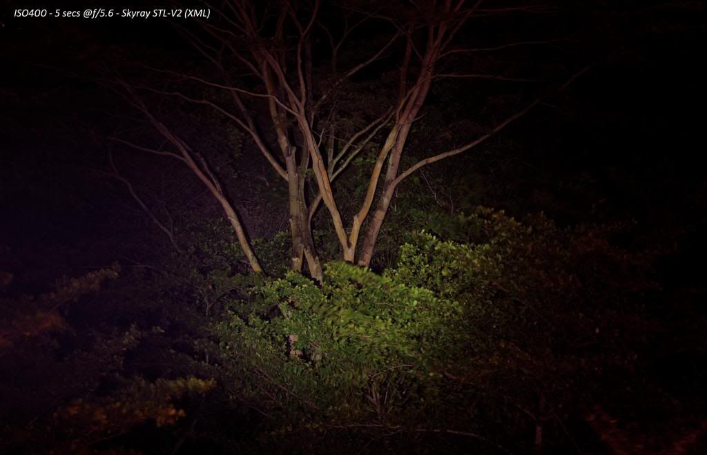

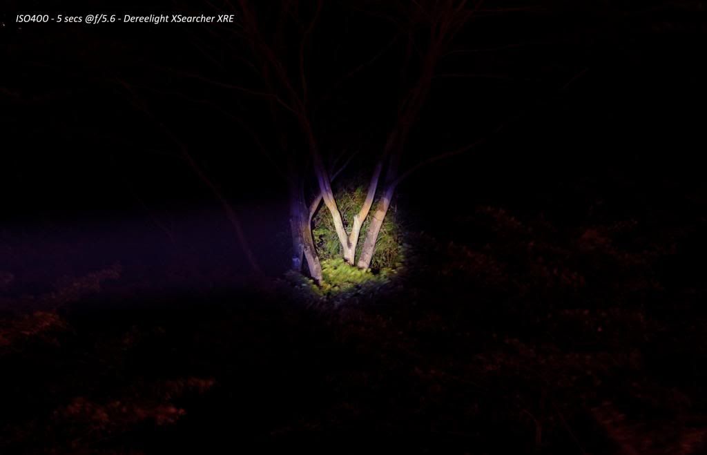

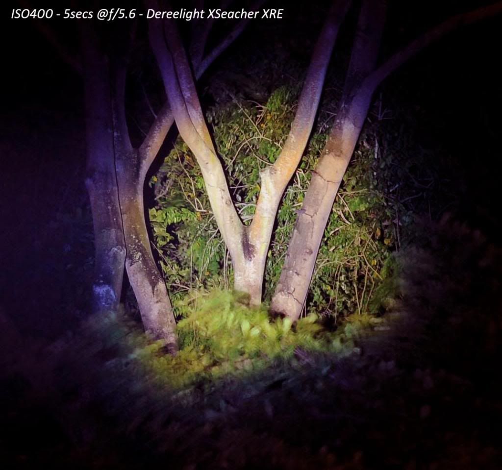

So I got myself the XR-E version after all. The XML version was good but it wasn’t what I was after. Anyway, to cut a long story short, I took some beamshot photos last night. In my haste I made the mistake of forgetting to take a control shot; but you can see from the Dereelight beamshot pic that the surrounding area is quite dark. I happened to have with me at the time my trusty Skyray STL-V2 (very good as a reflectored light, IMO), so I made two comparison shots. I know it’s not a fair comparison but it gives you an idea of the difference in throw. The V2 in my book is a very good light at its price point, but of course it’s no match for the XSearcher. See for yourself…
and the close-ups…
Distance to the target was about 160 yards and the lights were run for about 2 minutes or more before the shots were taken (on fresh batteries, of course). Bottom line, I’m a happy man :smiley: :smiley:
