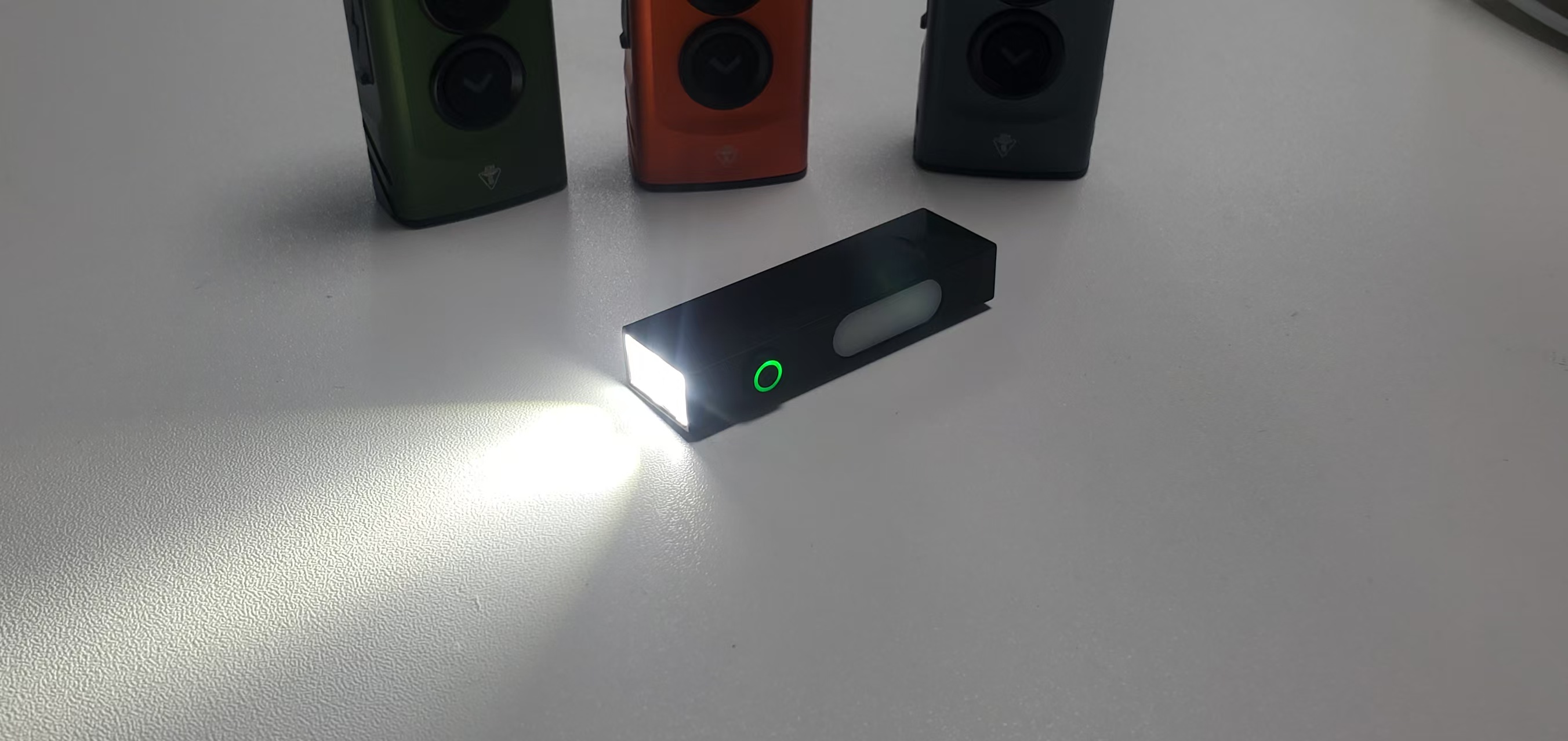

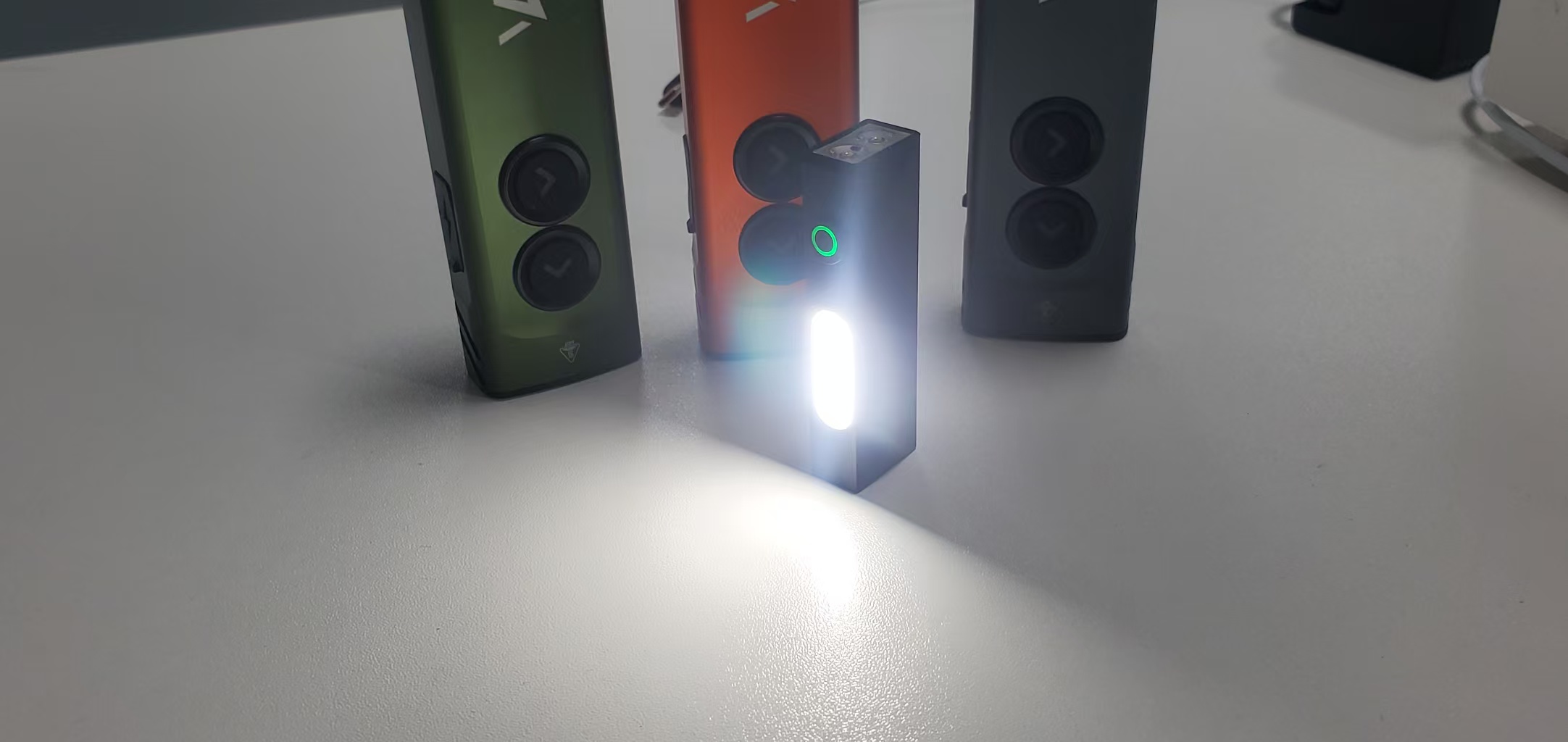

Dear BLF friends,
We are making a new product, hope we can get some great idea here.
Model Name: KC1
Style: Key Chain light
LightSource: Front(White)+Side(White and Red)
Control: Single Side button
Magnetic tail
Type C charging
UI:
ON/OFF
Click to turn on/off the front light.
From ON, press and hold to ramp the output from low to High, when it hits top or button it pauses, release and press to ramp in the reverse direction.
Double click: Turbo(From On/OFF)
From OFF, press and hold to turn on Red, press and hold again to ramp from low to high, or high to low, similar to front light ramp, double click to switch between white light and red light.
Lockout/Unlock:
From off, 4 or more clicks to lockout/unlock the flashlight.
Lockout warning
Press and hold to turn on low mode, release to turn on.
Design:
Please let me know your thought on it below. Thank you.
Best regards,
Daniel

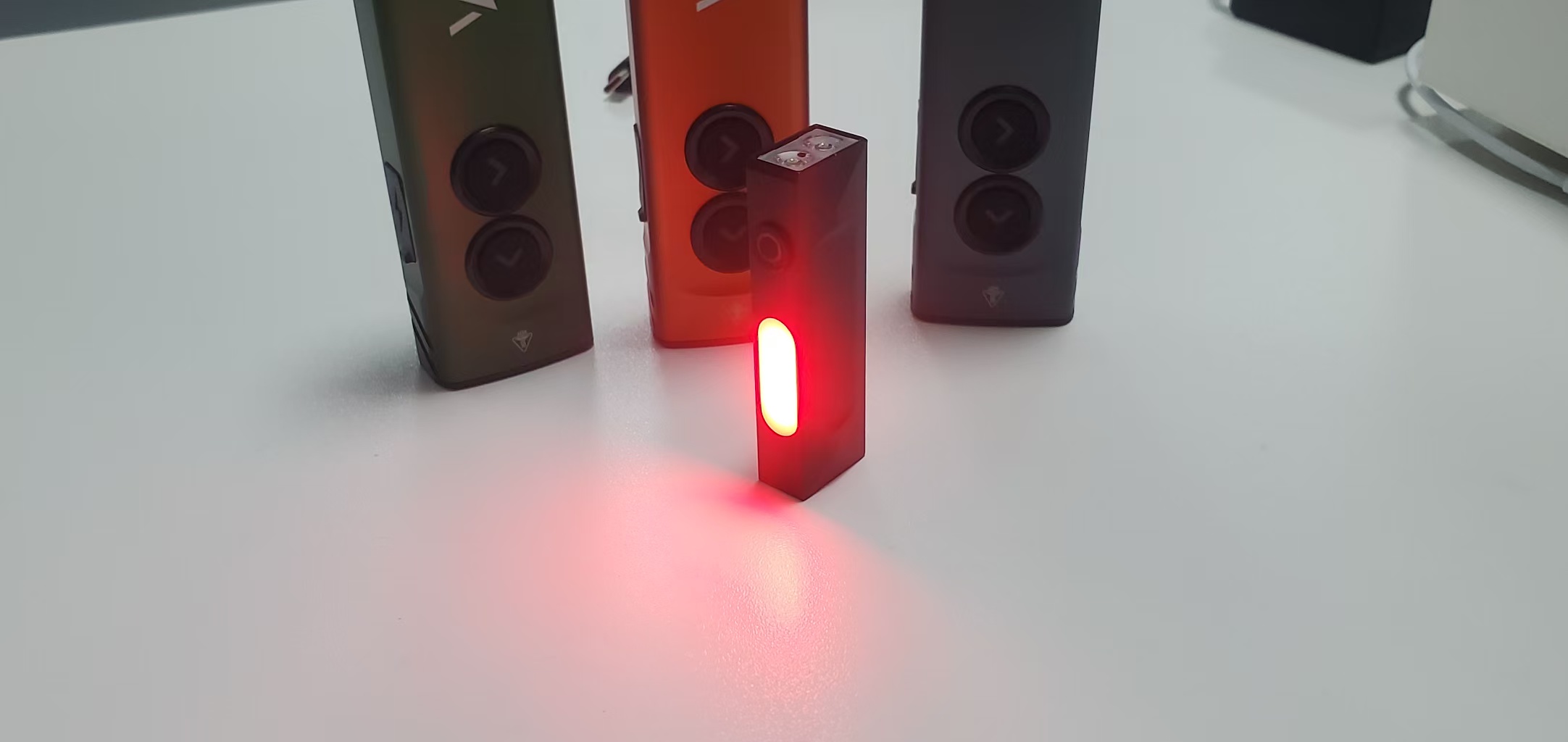

Red(not sidelight, the color)is a color we like to be able to see.
Red(the sidelight) a darker red not orange-red would be nice.

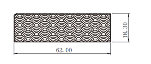

The Seigaha pattern is nice, but no anodization is going to survive being on a keychain, so you should probably make one that’s bare metal.

Like a solid Aluminum?

Yes, or better, stainless steel
