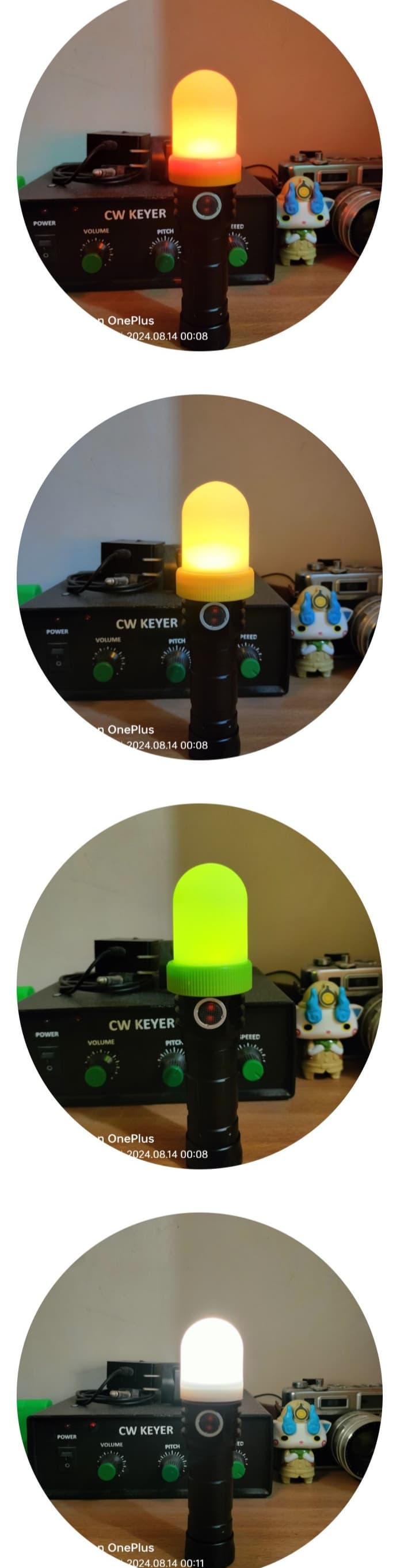

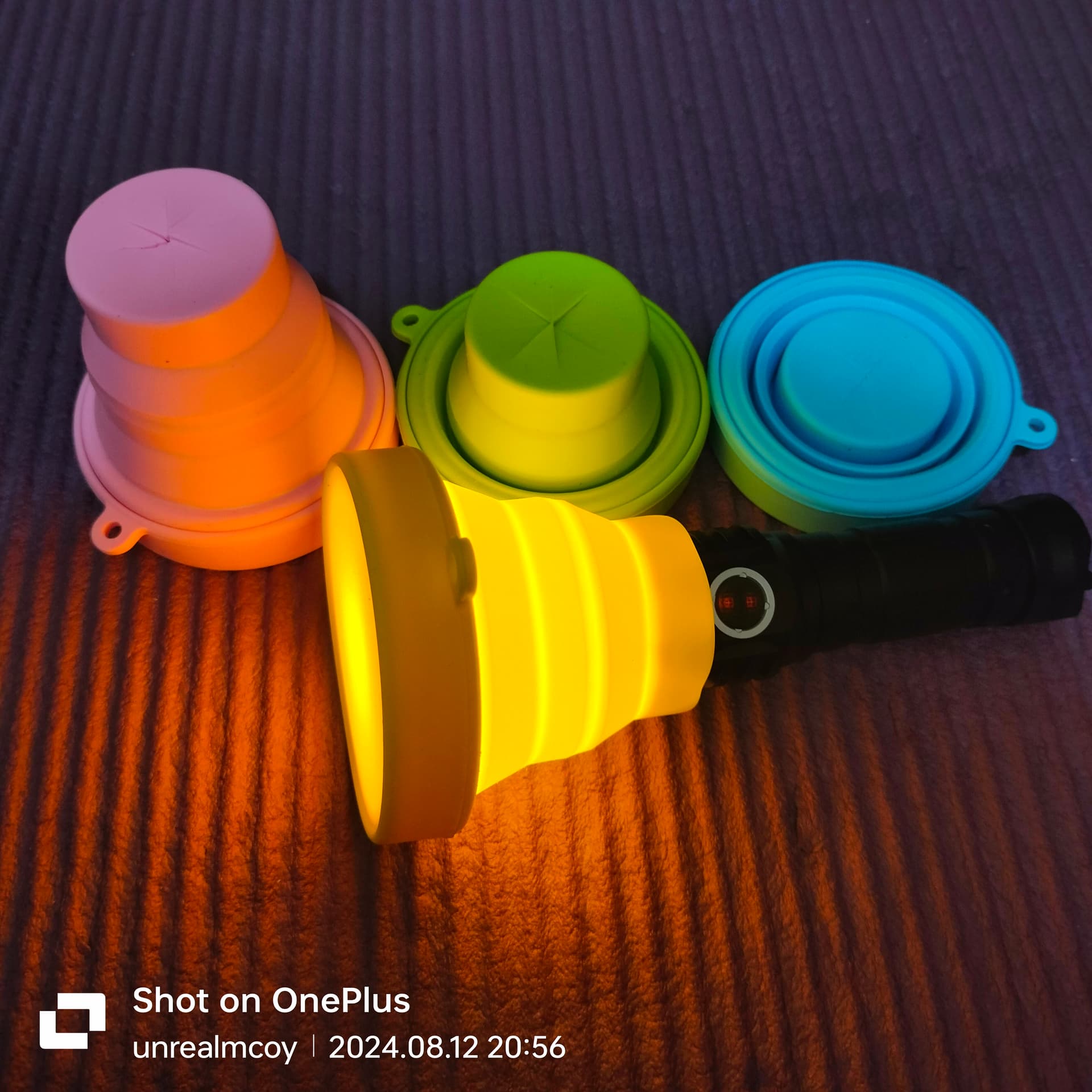

I have been experimenting on a diffuser for my Sofirn IF25A since I love its candle mode. For now, I bought all the available colors of collapsible rubber cups I can find and made an asterisk slice on the bottom. (an intersecting cross and x)
It looks like I can only upload 1 photo since I’m a newbie. So here’s the sample photo below. Since the cup is collapsible, you can make it long, medium, or short sized.
Enjoy.
They eat too much light. I’d just frizz out a cottonball or something, and set it on top. Maybe aquarium-filter material…
Hi Lightbringer.
I mainly use these for the candle mode in my Sofirn IF25A. I’m still in search of a material that will make it look like I’m using a candle light.
Your suggestions seems like a good idea. I’ll try them later. Hope you have a great day.

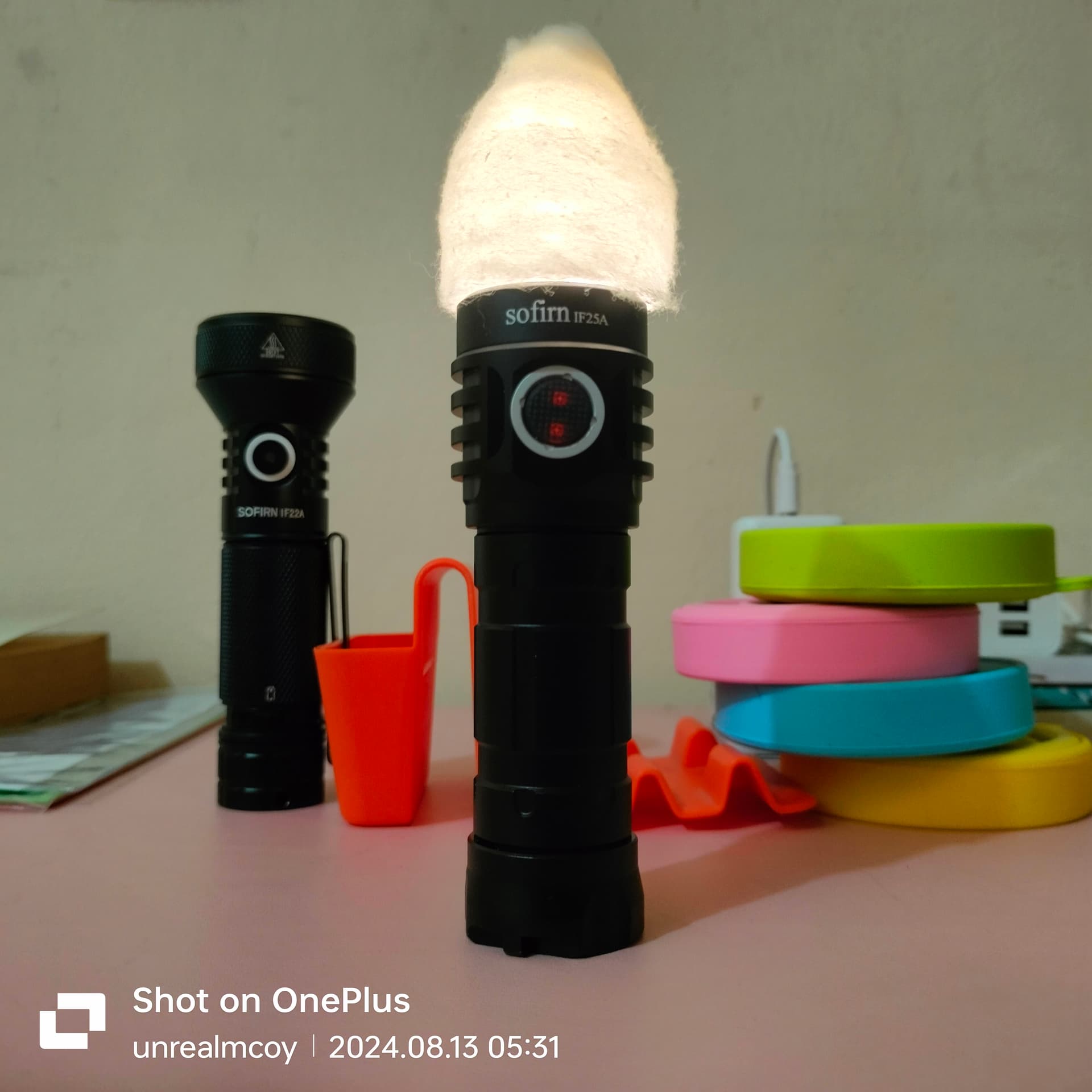

Wow! This worked better than I expected. This is a cottonball. I made it to look like a candle flame as best as I could. I’m using the Sofirn IF22A alternately with the IF25A as an ambient sleeping light. IF22A on moonlight, and IF25A in candle mode.

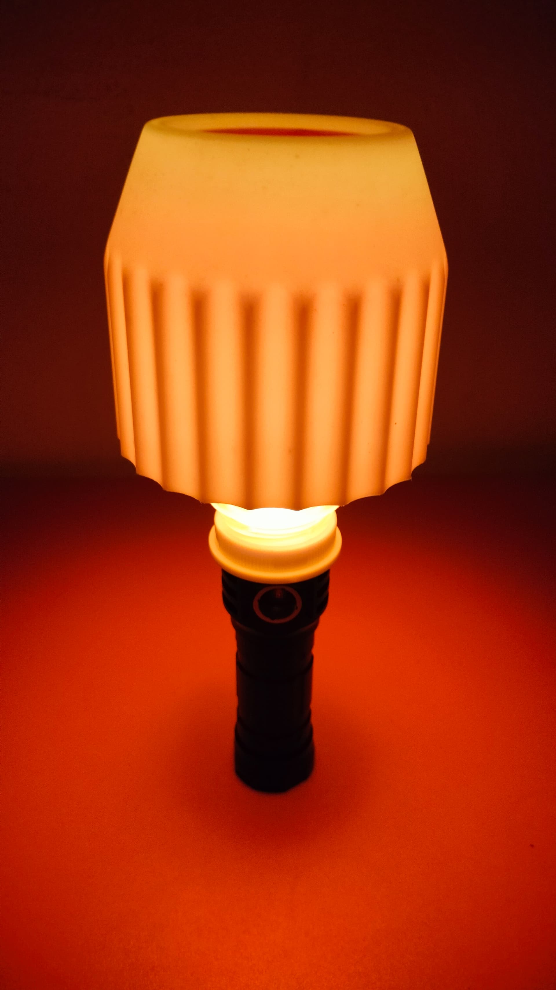

A slice of bicycle inner tube around the bezel, a small script bottle with the cap hollowed out and screwed into the bottle in reverse topped with a spray paint can lid. Everything fits tight, and provides a nice, even warm glow. Been using this on my IF25A nightly for more than a few years. I set it to sunset or candle mode with a 30 minute timer. I’m usually zonked well before the timer expires. Love it.

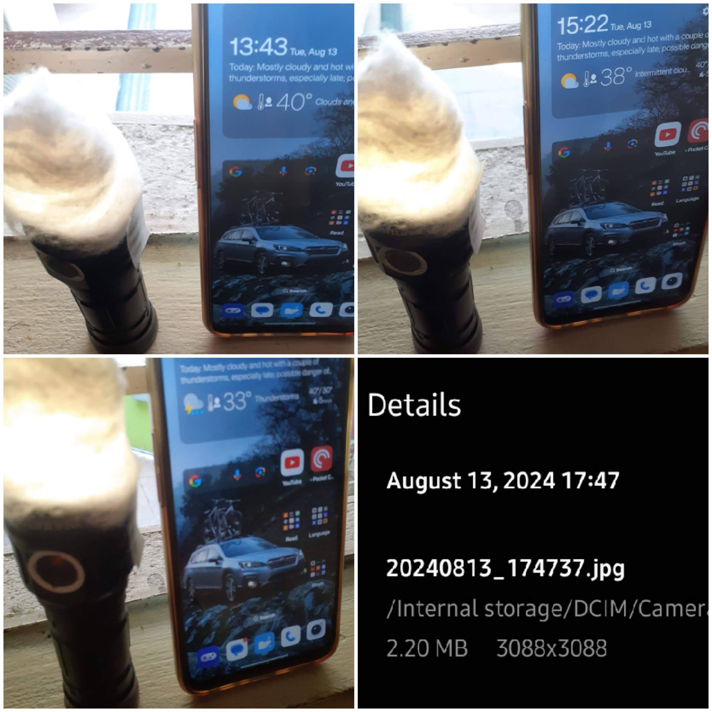

Sure looks nice but isn’t cotton like … highly flammable? :fire: :wink:
Hi Valynor,
Apologies for the delayed response — I hit the reply limit for new users and had to wait 10 hours before I could respond.
I shared your concern about the cotton possibly burning, as well as it being blown away if I used a fan, so I opted to use the air-conditioning instead.
When I ran the IF25A on the lowest candle mode setting for 4 hours, the body stayed cool to the touch, and the glass only had a slight warmth.
I ran a test this afternoon for 4 hours and I was pleasantly surprised that the flashlight produced imperceptible thermal heat. I had to close my eyes to feel for any heat that could possibly burn the cotton. I imagine it’s there, but my dog’s nose is probably hotter.

Unfortunately, I don’t have the materials you used, and it would likely cost me more than just buying a dedicated diffuser.
But in the spirit of experimentation, I’m going to try replicating it because I really love the design.
Thanks for the inspiration!
Yeah it should be fine on low, no doubt about that. But then again you are only one accidental (double?) click to turbo away from starting a fire, probably in seconds. :wink:

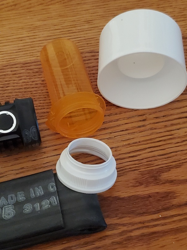

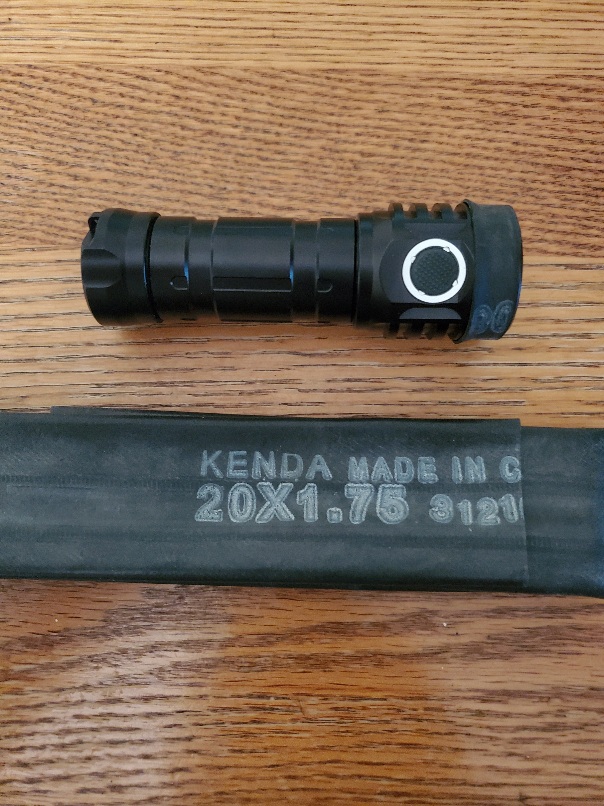

I hope you’re doing well. Could you let me know the exact product and brand of the bicycle inner tube? I’m not sure if it’s available in the Philippines, as my online searches mostly show black, red, and green inner tubes. The only colorless ones I found were anti-puncture tube liners.
It’s just standard black rubber bicycle inner tubing, 1.75". Here’s the setup:
Thank you so much… Now I understand.
I thought the rubber tube is outside and holds the cap and the script bottle together.
So the setup should be:
  1. a slice of bicycle inner tube is wrapped around the bezel
  2. a small script bottle with the cap hollowed out, then screwed into the same bottle in reverse
  3. finally, top everything with a spray paint can lid
…did I get it right?
:+1:
Thanks again.

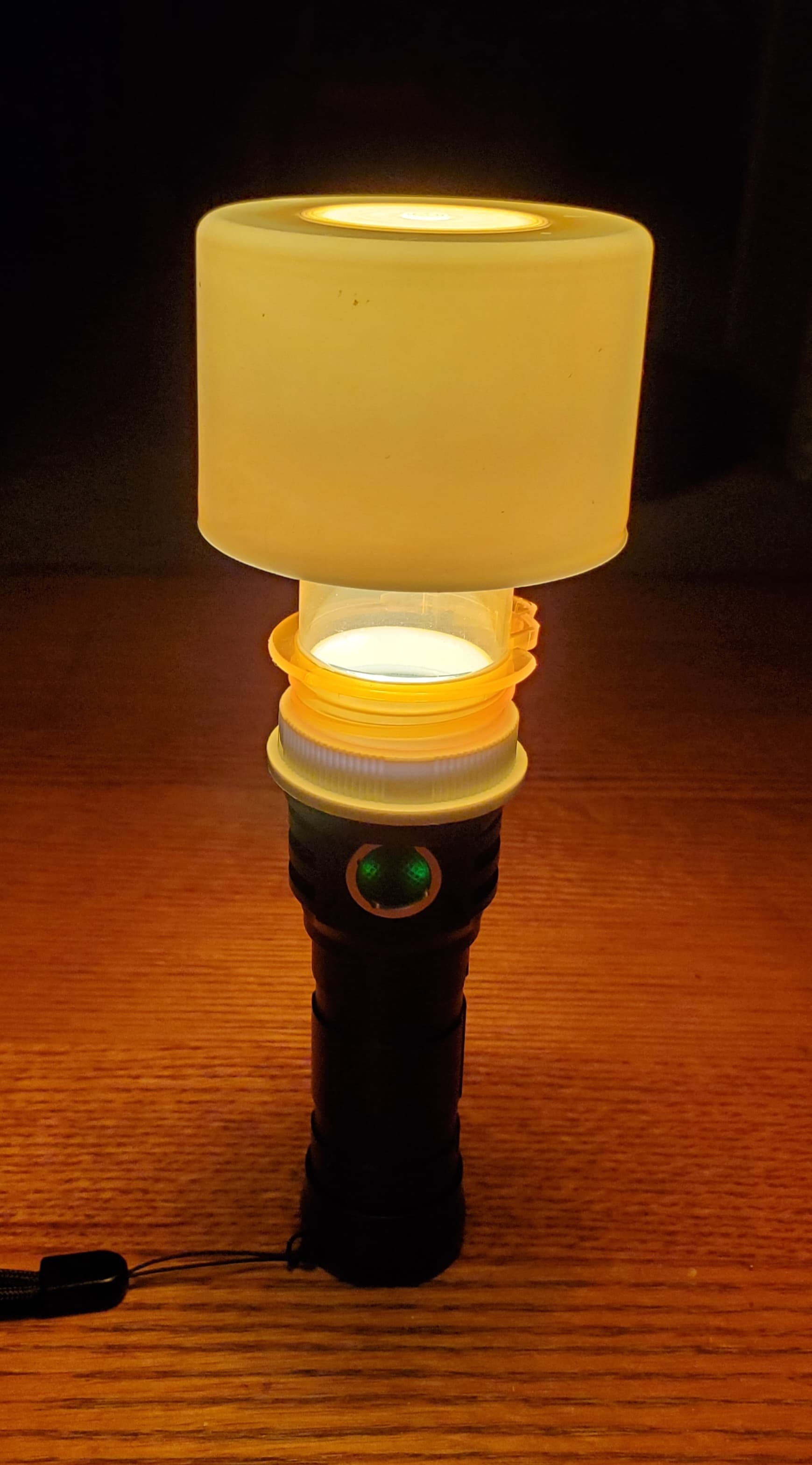

TIFisher!!!
I did it!
I couldn’t find a spray paint cap, but I found a plastic flower pot for 80 cents instead.
Instead of cutting it, I placed two medicine caps on top of the orange pill case to raise the plastic flower pot.
It’s not as good as yours, but it’s definitely an improvement from what I had before.
