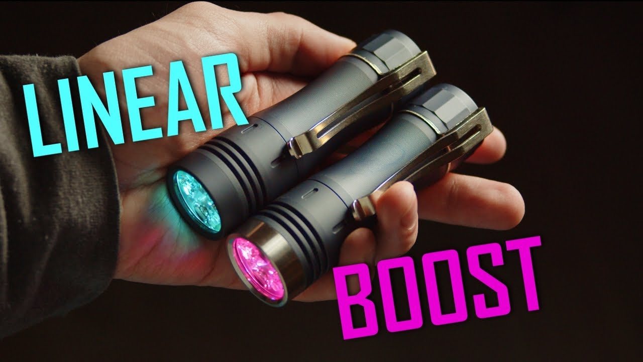

Luxwad YouTube channel mentions Boost driver
What’s that option? I don’t see it on the product page
luxwad says it’s $15 extra
Boost driver is the more energy efficient option. A traditional linear driver burns off the voltage difference between the cell and the LED as heat whereas a switch mode driver (boost, buck, buck+boost) actively converts the voltage. Unfortunately you can’t have that in a dual channel Emisar/ Noctigon except for the M44.
He mentioned it in the dw4 video
but I did find the video for drivers
You sure it’s not available in dw4? I’ll probably do linear regardless. Wonder how long this sale going for. Was since October and the countdown timer shows till the end of the month yet again.
Thanks I’m probably about set with the specs
Might add magnet tail cap, maybe maybe
Oh it is available for the DW4, I do have one with it. Just not the dual channel version, if you need two channels, you’ll need to make do with a linear driver. There’s just not enough room for a dual switch mode driver in the light.
