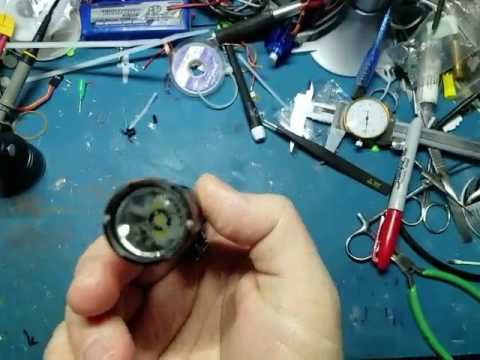

I did a functional test of the laser in situ:
And drilled a small (2.5mm) hole in the LED board to allow the beam to pass through:
Thermal paste was carefully applied so that it wouldn’t get on the laser’s lens, and then I reassembled everything as normal, taking extra care to align the reflector with the laser.
