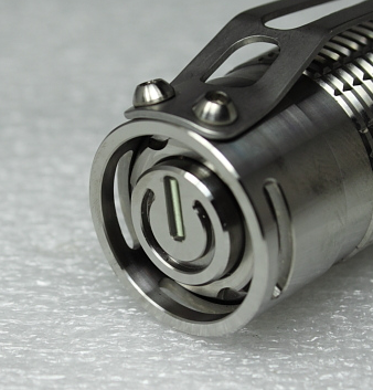

I'm thinking to make the trit slot here. on the tail button.
