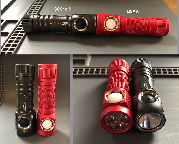

The D3AA is slightly thicker, and weighs 67 gm, while the Zebra weighs 63 gm (6% lighter), when both have Eneloop and no clip.

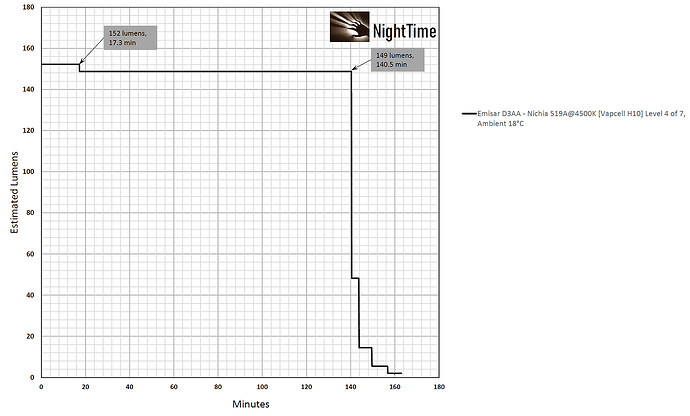

The D3AA has regulated output:
(chart from here)

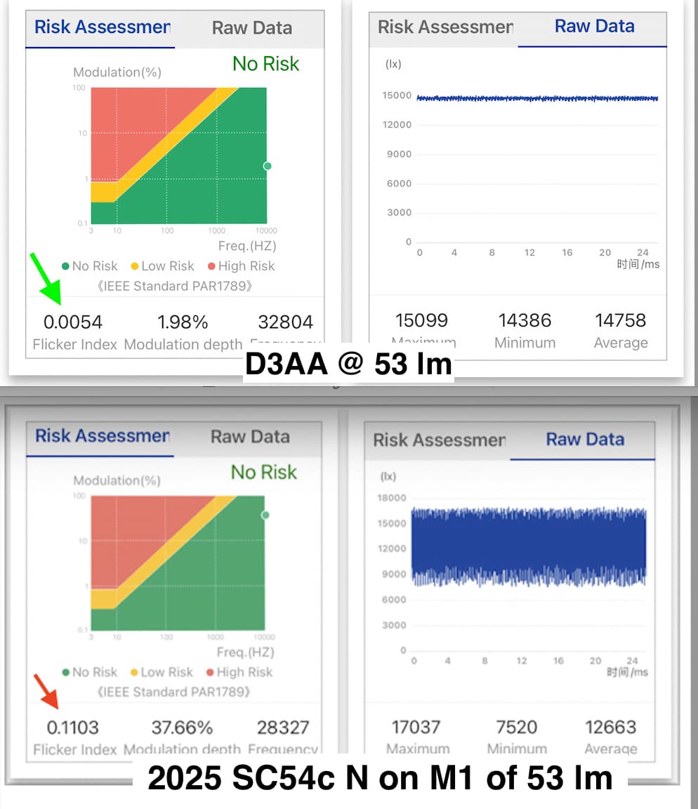

The D3AA has a lower Flicker Index than the Zebra:

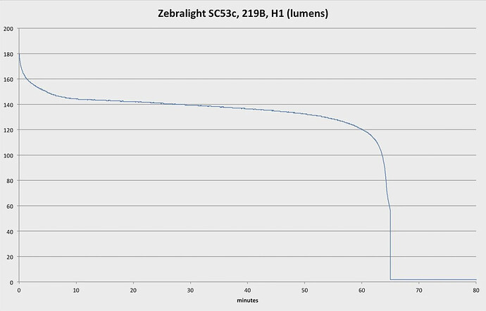

thanks for your comment, it made me go look at this more recent runtime chart from TimMc:
from this review
looks nicely regulated on M1, but the 200+ lumen H1 output is still not regulated

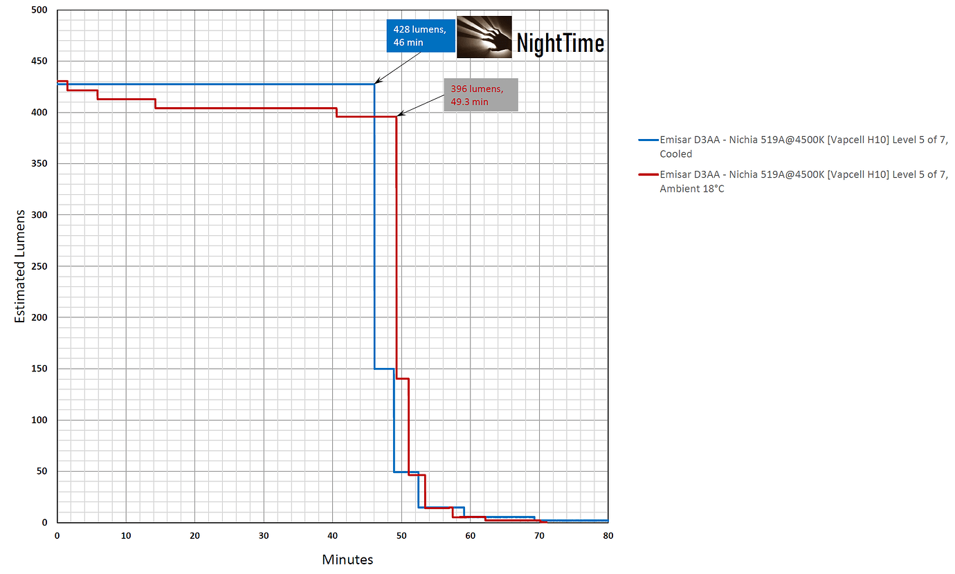

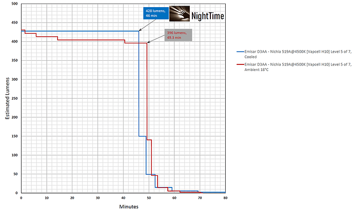

otoh, here is the D3AA, regulated at 400+ lumens:
chart from here

the H model has even nicer hand feel, no sharp corners, as well as being 9 grams lighter than the SC.
clip talk:
On the SC with the clip installed, the tip of the clip sits opposite the switch, which is not very comfortable for me when changing outputs. Removing the clip exposes the sharp corners of the pedestal the screws go into. So in both cases the SC is not as smooth in hand feel as the H model.

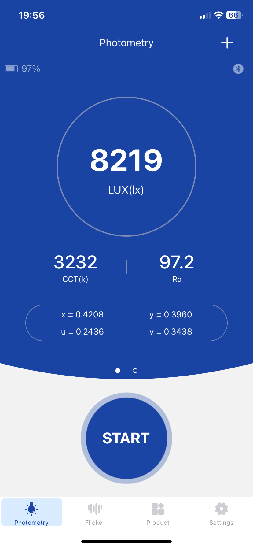

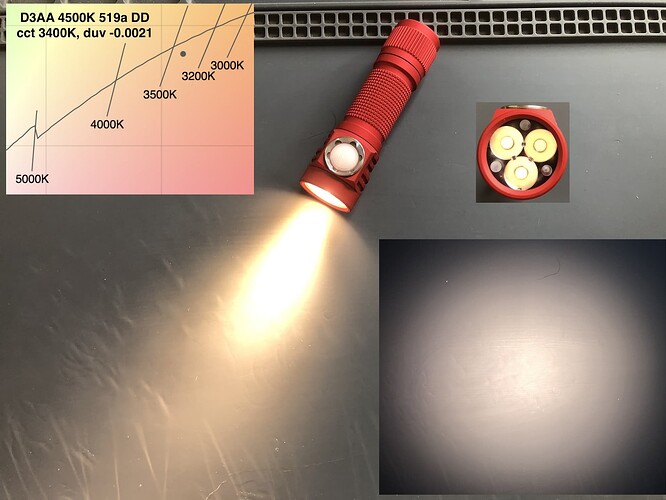

DeDomed 4500K 519a becomes 3400K, with tint below the BBL… (duv -0.0021 on my D3AA @ 50 lumens on Opple 3)

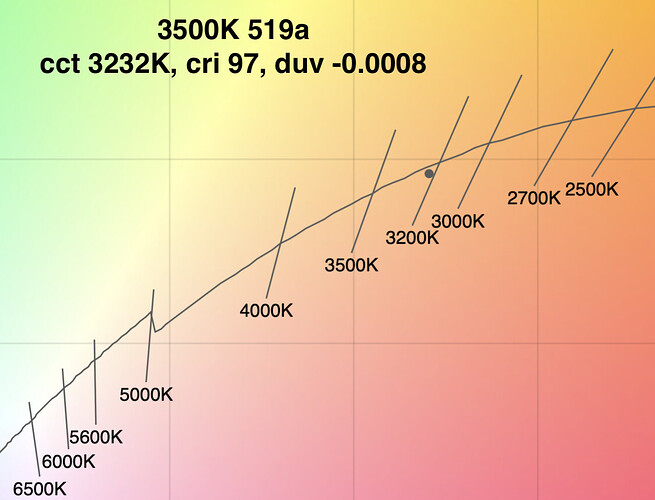

do you have a Tint DUV reference for the Domed 3500K 519a?

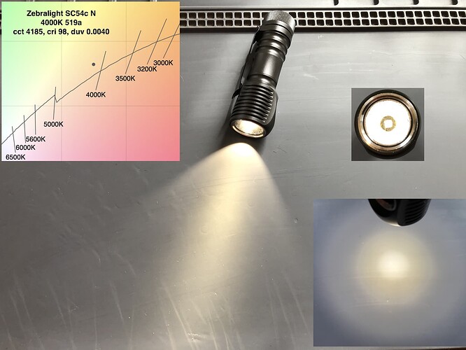

the Domed 4000K 519a in the Zebra has positive DUV of 0.0040 on my Opple.
domed
I can check
I prefer not dedome in this case for not lost floody spectrum
fwiw, in the D3AA the stock optic still diffuses the DeDomed 519a very evenly… It stays floody.
In fact my D3AA w DeDomed 519a is more floody (larger diameter and smoother) than a TS10.
I see, the optic is very floody (not super floody and for me is perfect.

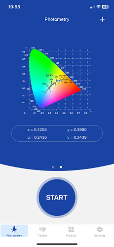

This is what i measured in less than turbo from almost 1 meter
Thank you very much for the measurement, Ive never tried a Domed 3500K 519a.
I see why you like it, I would too, as the tint duv is below the BBL:

here is an eneloop runtime chart for the D3AA
here is a link to the source of that chart, it has additional outputs on Eneloop…
here is another source of D3AA data on Eneloop

The D3AA has much lower Flicker Index than the latest AA Zebra… that was unexpected.
(these are my own Opple 3 measurements)
Notice how flat the lux line is for the D3AA, compared to how much the Lux on the SC54c N is oscillating up and down…
here are some of the other SC54c N Flicker Index results:
notice only one output has a straight line for the Lux output, all the other modes are modulating the Lux up and down… which produces a less desireable Flicker Index score…
The H53Fc N from both 2023 and 2024 have very nice constant lux, like the D3AA. The SC54c N otoh, uses more flicker than any of those.
The 53 series driver has more constant power to the LED, and lower Flicker Index than the 54 series driver
there are tradeoffs:

otoh, the Zebra SC54c N beam and Tint is embarrasing, with a greenish yellow corona, and a shadow ring in the spill:
here is the stock D3AA beam by comparison:
