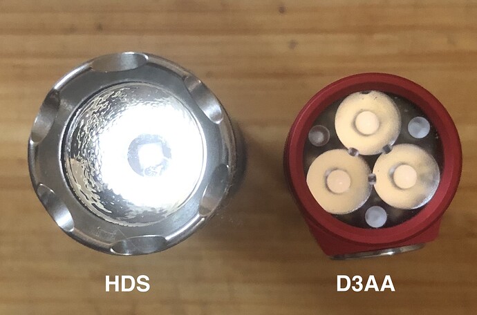

fwiw, the lowest level on my D3AA is way lower than on my HDS:
