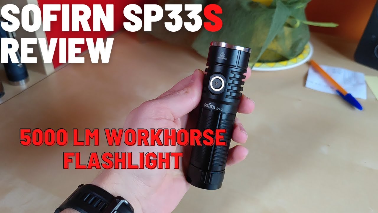

I’m confused I just watched this guy
Sofirn sp33 did 500 lumens for 6 hours, this seems to be better than emisar and zebra
The main reason I was looking at emisar is cause I can get nichia LEDs on it

That Sofirn is built to a price point, it’s not in same quality league as the ZLs.
It is cheap and bright though, so if that’s all you need…
