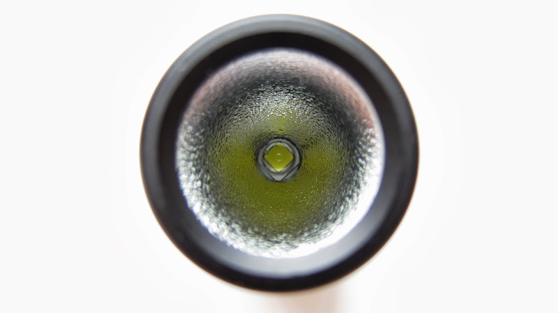

Keep in mind that the reflector doesn't sit deep enough to cover the LED, and therefore I filed the outer ring of the reflector to get out down and not lose too much light.
oh crap…got to modify? I guess we get what we pay for. :~
Yes, and no.
Did you refer to my post in the s5 thread? Or to the filing if the reflector?
For the reflector it's probably only 1 millimeter, max 2. Not that it's that bad in stock form though, but you can see it doesn't sit flush with the LED opening in the reflector.

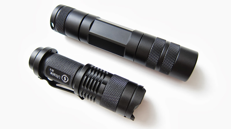

I received mine today! I can see why Convoy are so popular as hosts.
Some pics:
Nice glow in the dark cap, good feeling clicky:
Rounded threads and a pair of o-rings on each end. No lube but a couple of drops of DX silicone oil cured the squeaks:
Springs etc.:
Not perfectly centred but will fix this later:
No logo, nice anodizing and knurling, lovely size too:
Pocket clip outside the bubble wrap and box so it won’t damage light during shipping. I won’t be fitting mine as I don’t need it:
Box was wrapped in lots of bubble wrap too.

What you said about the emitter was also true for mine. When I opened it up, I saw why. Because the reflector is a little too long on the outer ring. If you file that down, it will automatically fit better. Led star has some grey grease on it, so it will move around easily!
Thanks, ChibiM! I will do that this weekend I think. Is the reflector metal?
Alu
