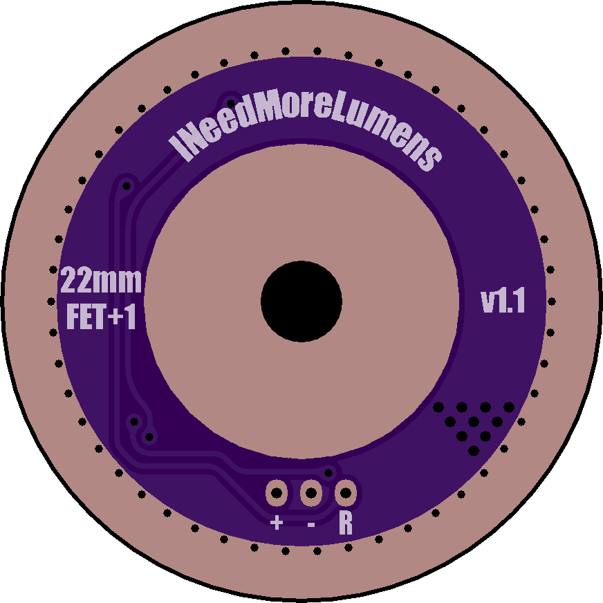

I designed and built my own Anduril2 FET+1 driver for it:

It’s just a FET+1 that uses a T1616 MCU.
I used a PFET instead of a diode for RVP/RPP, that increases the voltage to the MCU about 0.2v to 0.3v.
That should help with FET RDS(on) to squeeze as much current as possible.
There’s a hole in the center for a + spring bypass,
I’m using 18ga wire in my D2GC/XM-MR.
I don’t have the 3D renderings on my phone but here’s pictures of the PCB:
6 Thanks
So the fet part is basically direct drive? Or is there a current limit? Asking because XM-MR has Vf high enough to drive it straight from a solid 21700 to reach max current
It uses PWM but on turbo it’s basically Direct Drive.

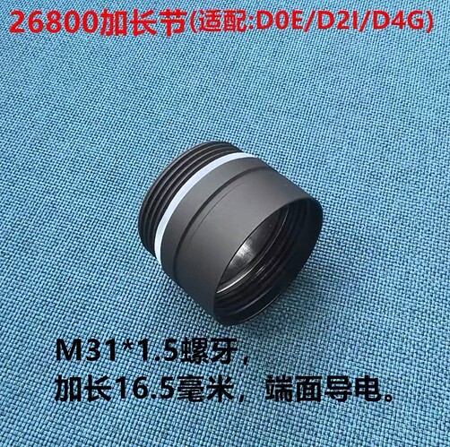

They have a similar sized tail switch light that uses a 26650 battery and they have an optional 26800 extension:

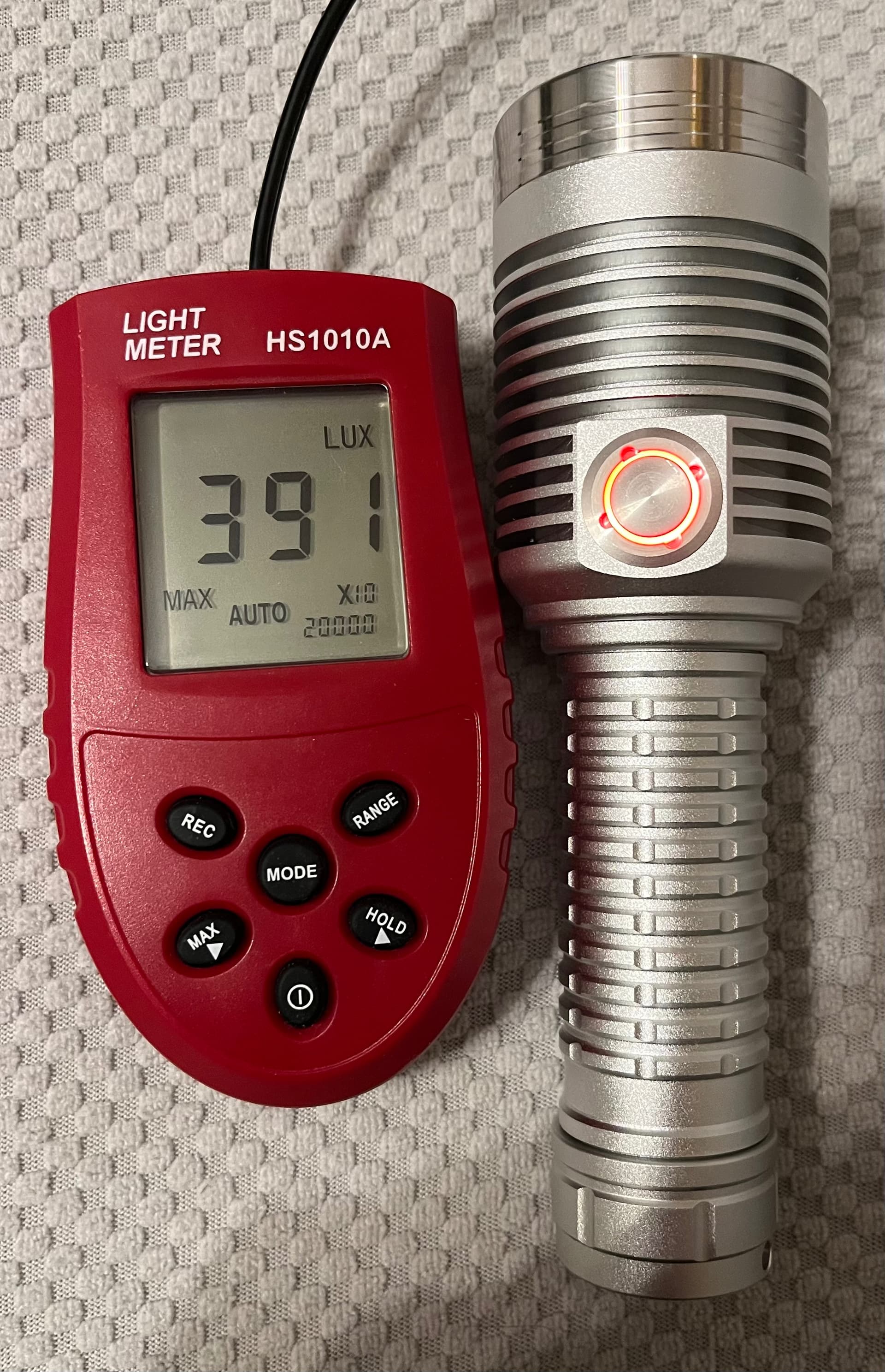

3,900 Lumens at Power On:
3,700 Lumens at 10 seconds:
