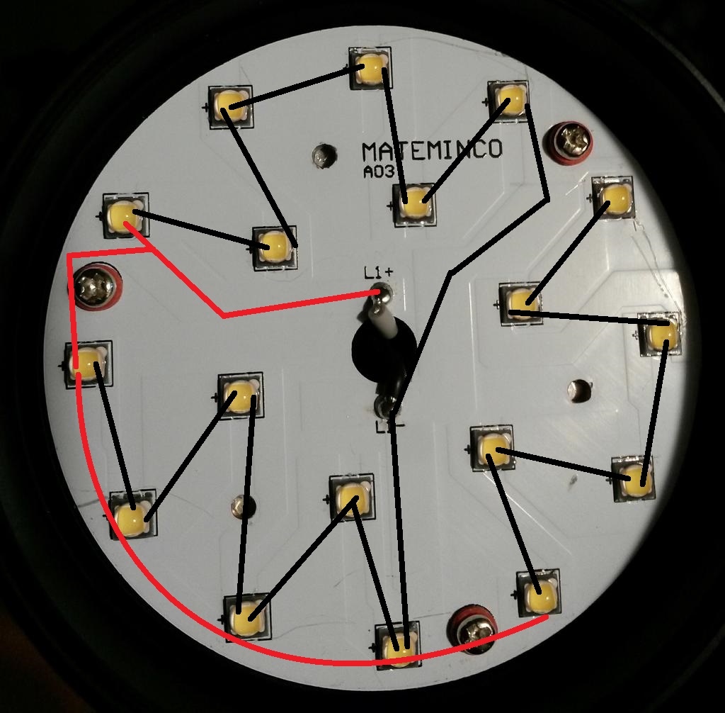

Just a heads up, Lexel. It looks like the 2nd generation of Astrolux MF01 have a new wiring pattern on the mcpcb (along with a new driver design). We will have to see if the TA driver can be compatible with it.
[image] [image] I just got a my nichia 219c out of the mailbox.Looks great not a mark on it.Here are pics of the new driver and mcpcb. Alot different that’s for sure.Igot 10701 lumens with 10100@30s. on fresh vtc6.I’m going to check again after while to be sure i got it right.
you would have to modify the MCPCB

Just a heads up, Lexel. It looks like the 2nd generation of Astrolux MF01 have a new wiring pattern on the mcpcb (along with a new driver design). We will have to see if the TA driver can be compatible with it. https://budgetlightforum.com/t/-/46324/1698
6S LEDs? and holds 4 batteries? Not without ledboard modifications. Not a chance.
