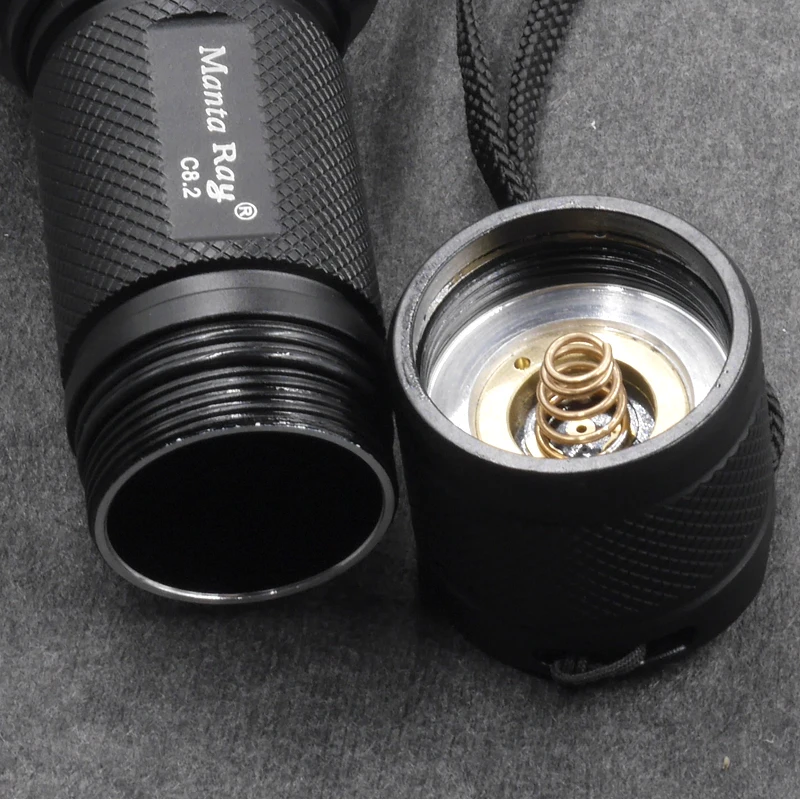

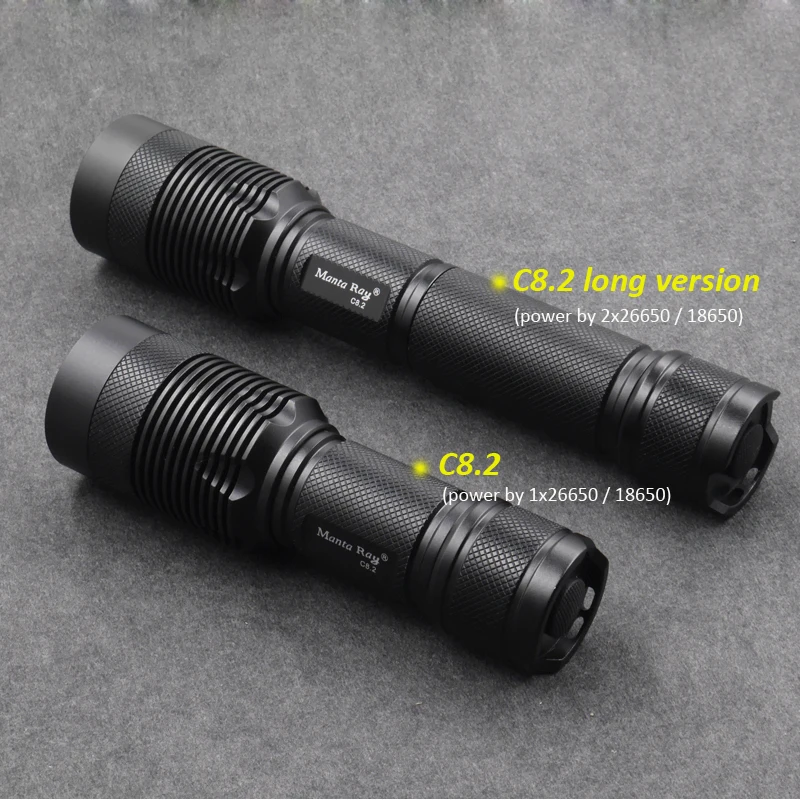

Yeah, that’s the one. I only have the short version but it is essentially a C8 with a 26650 tube and massively overbuilt head. Even the one I modded with a copper spacer, 6x Luxeon MZ’s, and a 12A driver handles heat like a champion. It certainly isn’t a pretty host, but on a utilitarian level it’s fantastic.
Barkuti, do you know how those compare to Kaidomain hosts (such as this one ) and how much space there is for a driver with a large inductor (I’m thinking XHP70.2…)?
