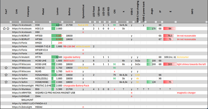

So far, I have considered the following models:
When meeting exclusion criteria (in red), I have sometimes not filled in any further data, so the cells are simply empty. In orange, I have marked what is not optimal for me. Have I forgotten anything? Are there any mistakes?
I know it’s a tall order, I am looking forward to your suggestions. Thank you very much,

It seems you have soem clear requirements and have done some digging already. I am curious about some things:
  1. What are your usecases for the headlamp?
  2. why do you need the light to be symmetrical?
  3. What do you mean with “power button on the back”? Not very clear what you consider the ‘backside’ on a headlamp.
  4. Open os - headlamps are mostly used as ‘tools’ and more simplicity focused. This is probably a very limiting requirement as there are few ui’s that are open (anduril being the most popular).
I don’t know what to recommend exactly because of the questions above, but here are some general things that may help you choose:
Sustained lumens
Given your requirements prioritizing sustained lumens is probably what you are looking for. Unfortunately, only max. lumens are generally clearly advertised, and there isn’t a database you can check for a lumen level that is sustained for a certain amount of time. The only way to find out is to look at reviews with performance graphs per light.
Shock resistant
There are differences in “shock resistance”. This depends on your usecase, but most ‘good’ brands have good enough impact protection for drops, bumps and the like. On the top of my head this includes acebeam, fenix, nitecore and even models of sofirn and wurkkos. And while emisar/noctigon lights are really cool, and generally among favourites on this forum, tthey aren’t necessarily the most sturdy for shocks and falls.
Some brands prioritize sturdyness (armytek, surefire, malkoff, elzetta etc.) But they sacrifice other areas (CRI, tint, size, output, modes, features etc.) and are generally focused on the tactical/weapon mounted crowd.
You might be better off with other brands for your need.
Let us know your usecase and i am sure there is a flashlight nerd among us who can help you find a suitable model.

It’s good to come up with a list of wants.
If you haven’t had a few different headlights you might not fully know what you really want and why.
I agree that high cri and a wide smooth flood (120°) are important.
I believe that insisting on a centered LED is unnecessary and rules out way too many lights for no good reason.
I would recommend you go and watch a few more YouTube videos of the armytek model on your list. And also the video of the 3000k model.
