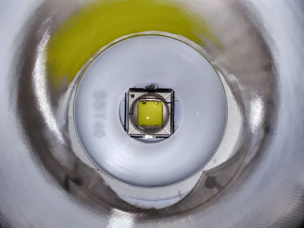

Using a 20mm board should be fine but you will have to center it proper your self. You could always drill and tap new screw holes if you wanted. The reflector base is fairly big ill check clearance now. Okay so the reflector hole is huge lol if you use the stock gasket it fits all the way around a 20mm board so that will act as electrical isolation
Gasket size is 23mm overall
Reflector is 62mm (outer ) Looks almost 60mm inner
Bottom opening in reflector is 18mm
MCPCB is 28mm
Lens is 65mm
Driver 30mm
Bloody hell.
Might just be easier to get a 28mm pcb and reflow it.
Got the sst-20 DA L3 (5000K) in mine, used a unmodified maxtoch 26mm mcpcb. It netted exactly a 25% increase in measured kcd.
Today I will pick up my CW from post office. And then I can compare with the NW. Later I will put in a White flat in the CW version.
Wonder why they made the reflector so large at the bottom? At least you can fit a MTG2 in there no worries lol.
I ran some more numbers i got about 2230 lumens and 230kcd from my cold white stock. My cd is always low but lumens seems fairly right.
How did you get it to fit? The 28 mm barely clears the solder pads. What are the exact throw #'s? My 2nd NW does about 230 kcd, my 1st one after the mods actually seemed to drop throw to 238 kcd. I'm not too surprised because any fiddling with LED/MCPCB, etc. can change things slightly, enough to make a difference. The modded one though has a better centered beam pattern.
Well I blew up that de-domed emitter. Must have nicked a bond wire. I had to reflow it from the 20mm over to the 28mm; still had to cut the gasket because I obviously can’t solder well. Light went white, then blue, then purple, then nothing.
Oops! Lessons learned. Although I’ll most likely need to try and get another gasket somehow, sigh.

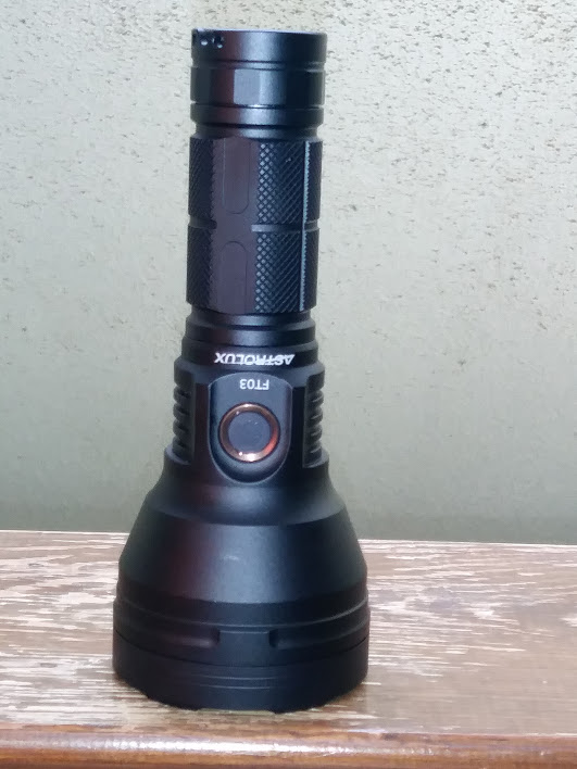

-LED seems perfectly centered :+1:
-Bezel and Body NOT GLUED :+1:
-AR Coated Lens :+1:
-I disabled step down. Popping/clicking noise started after 1 minute of turbo.It was sporadic and Not too annoying. More than 5 minutes after turning off to rest, still making popping noises!,a few per minute!
Ran on turbo for 10 minutes/tail stand/no fan/Loft Temperature was 68F/20C. I was able to easily hold handle of light after 10 minutes of Turbo. NO RED HAND EITHER!
I look forward to using it tonight. So far I am pleased w/Lens/LED centered and NO glue! :wink:

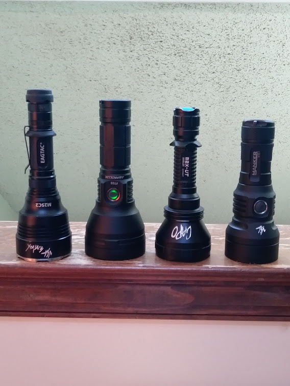

Comparison/Line up from Left to Right.
M25C2vn T———FT03———M2Xvn———U21vn
