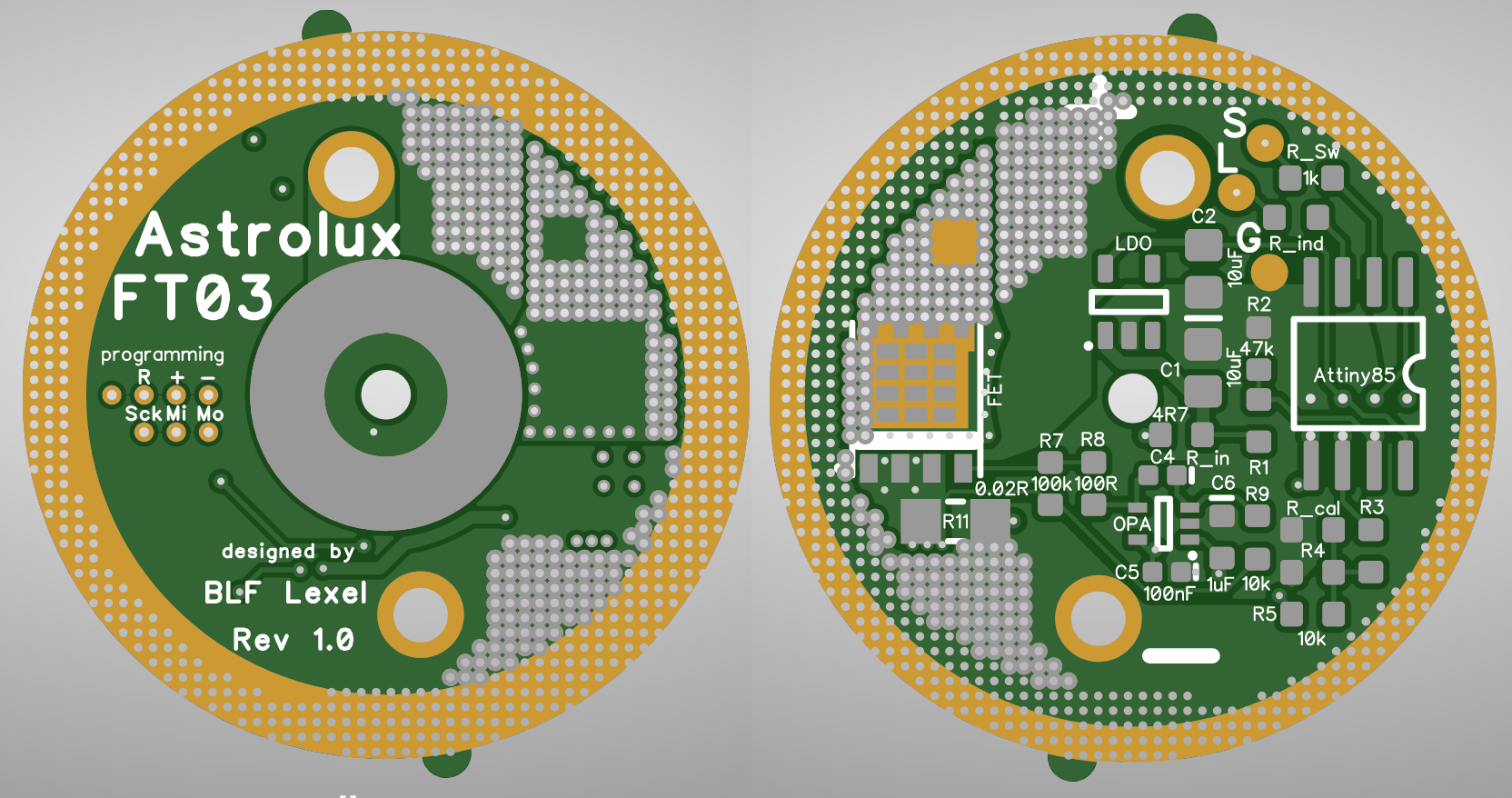

[in Design process] FT 03 CC FET white flat driver

I realize that you know what you’re doing, but is there any chance that the heavy stitching on one area of the board could weaken the PCB in any way? After all, the board may see strong stress from the spring depending upon the light and battery fitment. The renderings make the board appear relatively weak on the stitched half when strained at the center.
