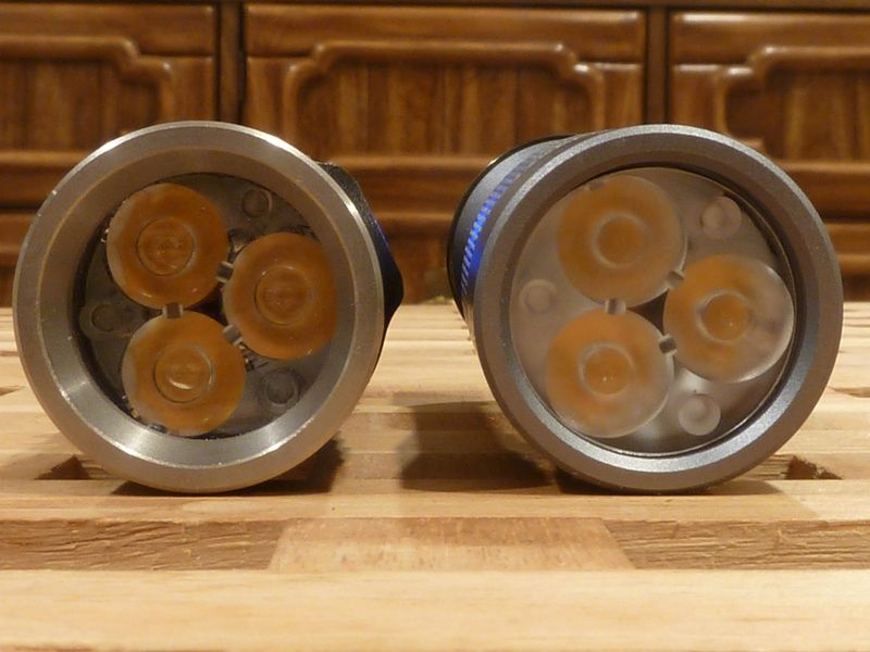

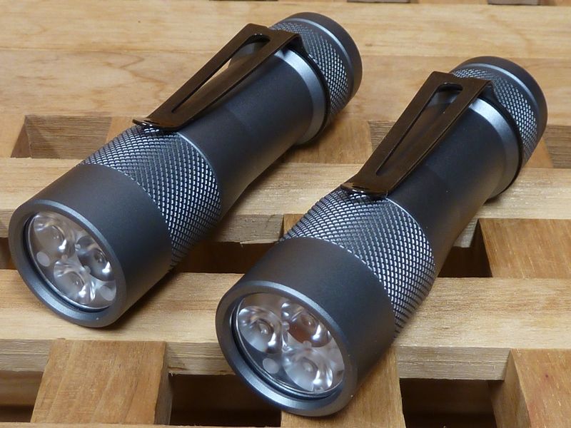

Received the pair of FW3A's, one 3D, one 7A - wow, both in exc. condition!! They are super small and light, as everyone else is say'n.
The 7A didn't work at first, but it had the same loose driver retaining ring problem. In fact when I took out the cell, the ring was almost out of the head. Simple fix - threaded it back in, tightened up after assembling, gave an extra twist to the tail, and it's work'n fine. Took a bunch of pics this eve.

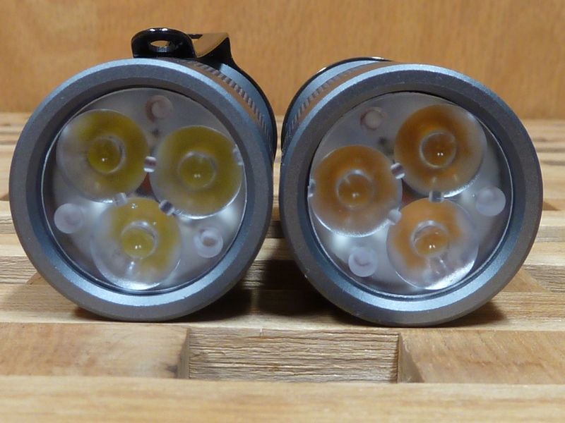

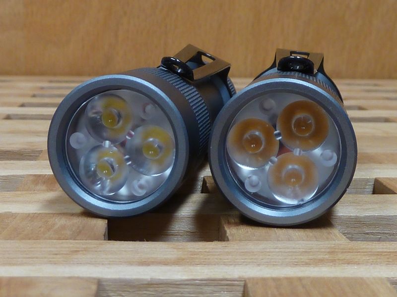

3D on the left, 7A on the right:

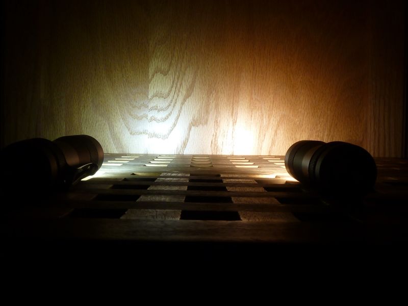

The wood really brings out the difference. Was tweak'n settings to get the pics to look like what I was seeing here, and think they reproduce the differences well:
Dont' think the 3D looks this blue in real life though:

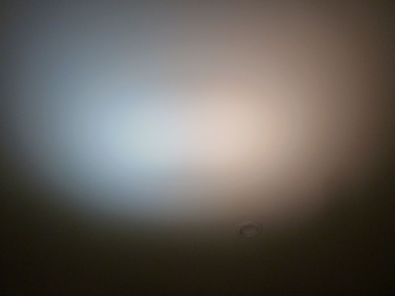

This is the ceiling shot of the lights as positioned above. Dunno why but it kind of, sort of looks like this. Not sure why but I do see some blue/green in the 3D. I think it's all relative though, next to the 7A:

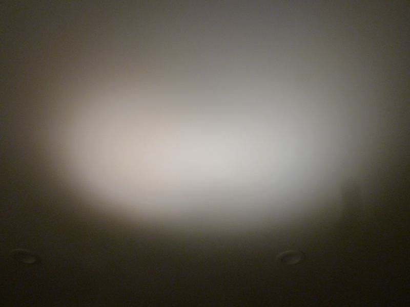

Zoomed out a bit:

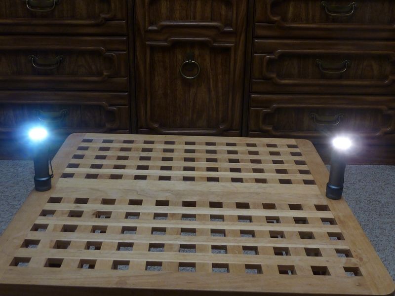

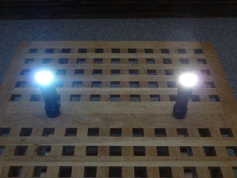

Another shot on the table. These are no where near ramp max, I think they are on the 1x7135:

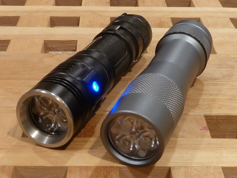

This is next to an ol C20C, modded with an XPL HI 2700K triple bought from Richard at MtnE:
You can see below, the 2700K does appear slightly warmer than the 7A, as it should be:
Here you can see the 2700K does appear warmer than the 7A, but the colors don't quite match up. I have an Old Pana Lumix camera set for Auto white balance - other settings looks pretty bad, so I stay with Auto. It's good for relative comparisons though all in one shot:

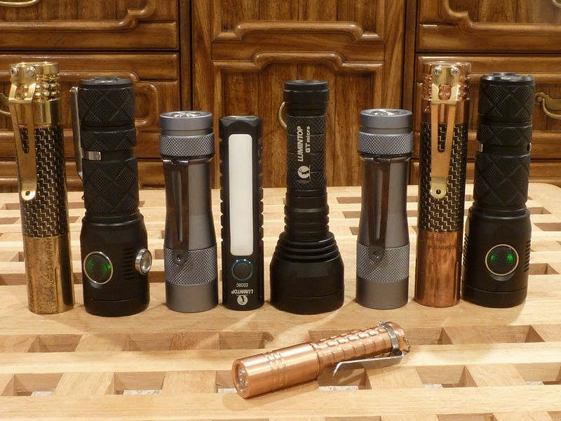

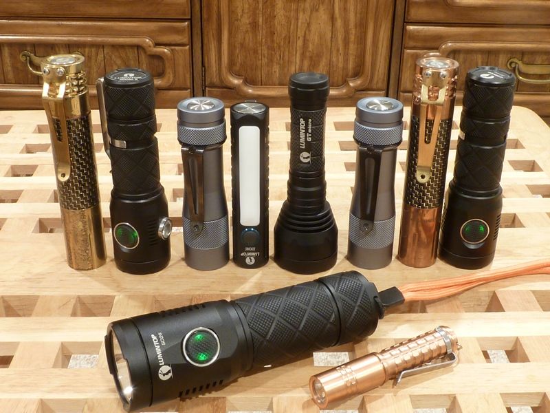

Some Lumintop EDC family shots:

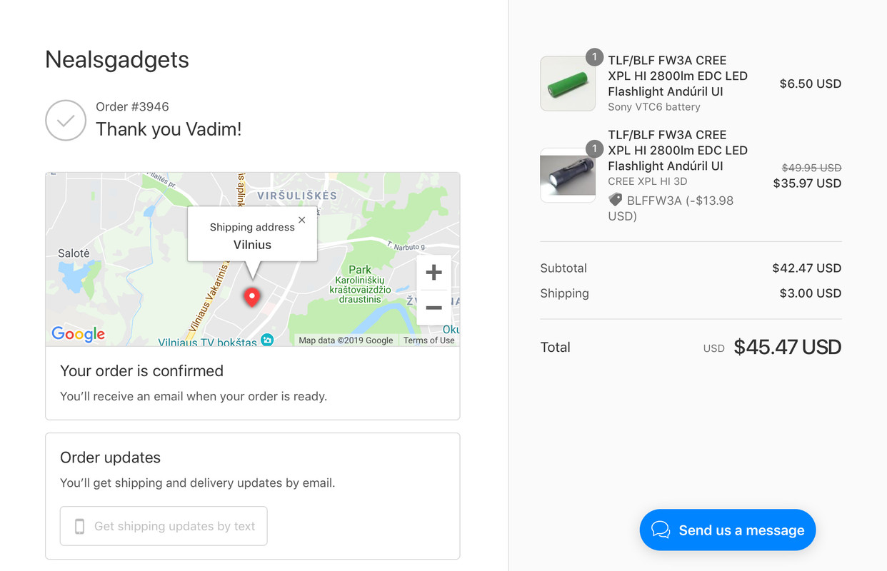

Well, I cannot do this yet. I have payed for a light, but to no effect. Yes, I have to acknowledge that I have done that not immediately after I have received a notice, but… Looks like there was absolutely no control on who and how many lights orders.
So I am sitting now without money and without any shipment notification:
That’s the only way a GB here can work, when the codes are sent out can be based on the list but not shipments.
FWIW you’re nearly 500 orders past mine and my shipment just made it to the states a few days ago. I would bet money your order was right before the Chinese “labor day” type of holiday if pretty recent, and Neal’s wife gave birth not long after that so there were some delays for sure.
I think we’ve just barely hit the official ship date too, the first batch of lights came in earlier than expected so a few hundred of them went out more than a week ahead of schedule.

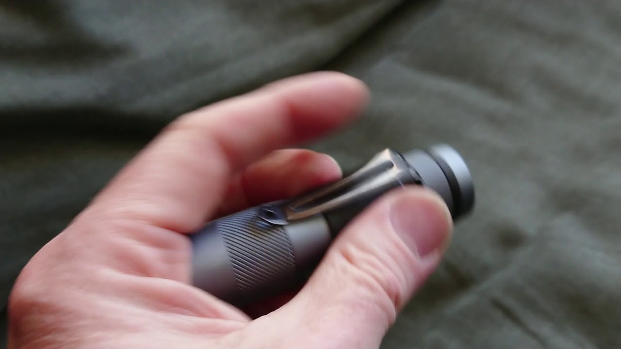

It was an attempt at making the point that adding grip to the battery tube makes the light easier to handle. But that was not obvious from this video I guess :smiley:
